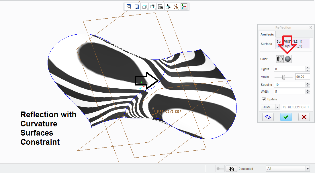

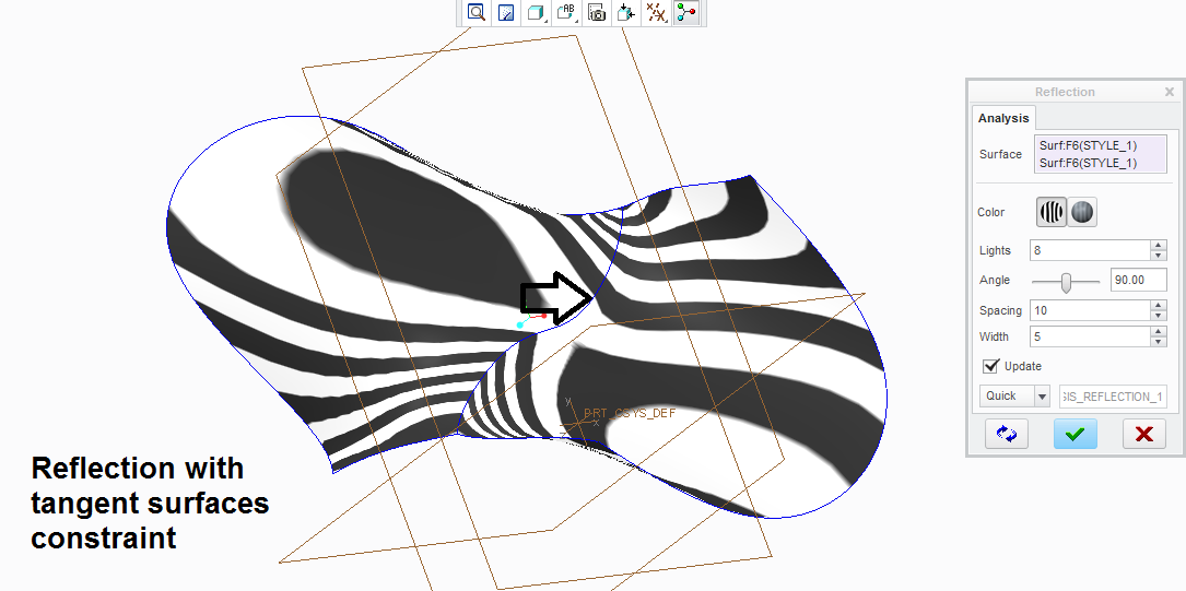

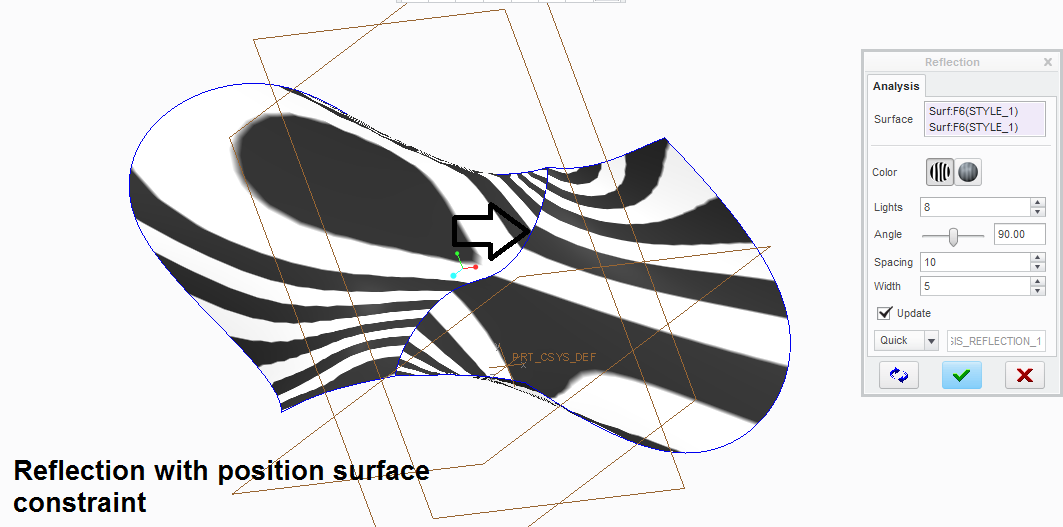

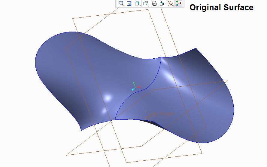

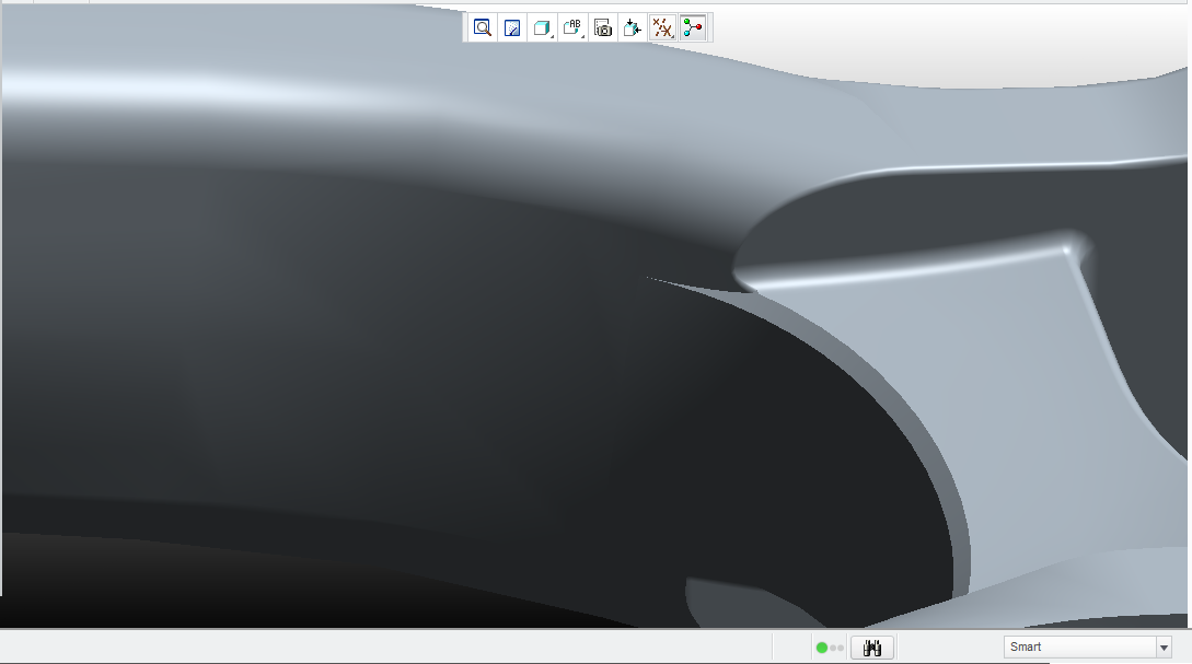

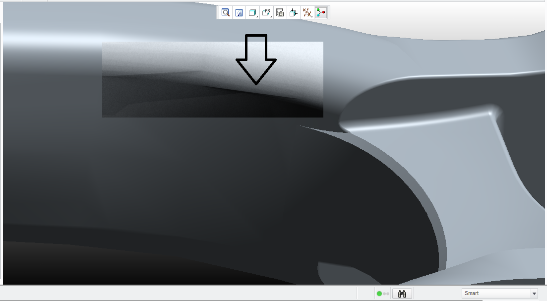

John,
This images could be helpful for you.
This is a Style feature, check in each of the picture the transition between the two surfaces. The reflection analysis tool, is (at least for me) an intuitive tool to analyze surfaces, you need to check how the lines changes through the entire surface, often smooth transition of these lines result in smooth surfaces. Rotate the model an Zoom in in order to attend tiny details and sharp transitions, remember that you can toggle between two colors in order to see better the effect (last picture). Notice also, that if you do not do this, is really difficult to find those details just using the shade view (first picture).

In the reflection interface you can also "rotate" the direction of the stripes, this can be useful because sometimes a surface looks good in one direction but has wrinkles or bad spots in another direction.

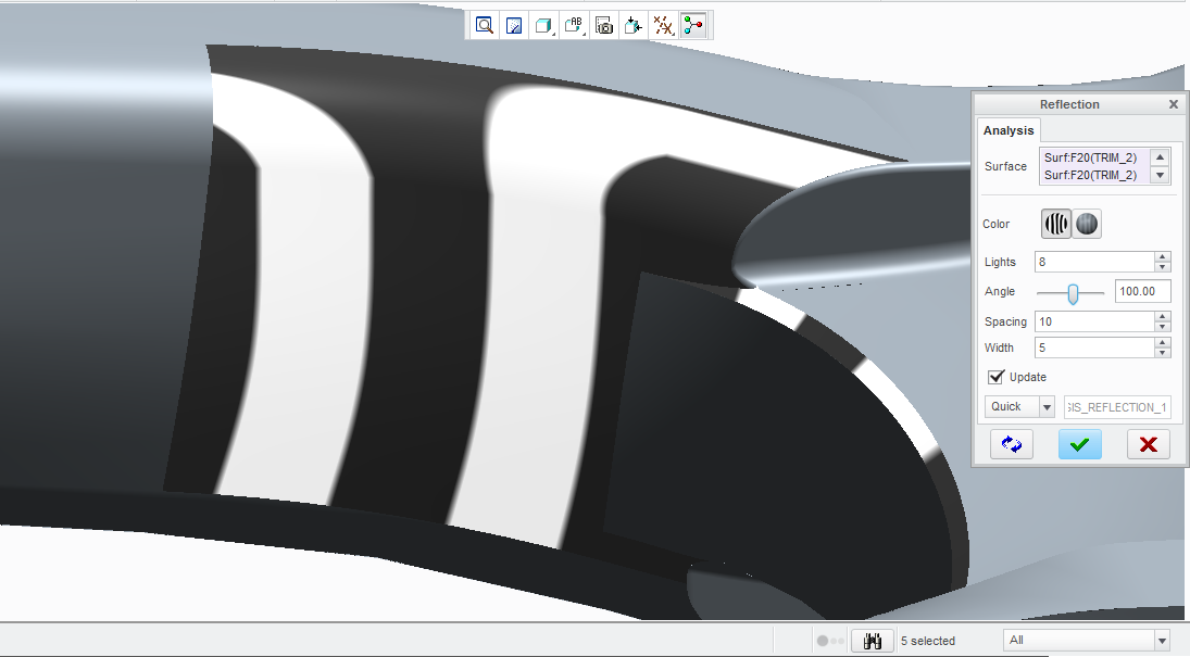

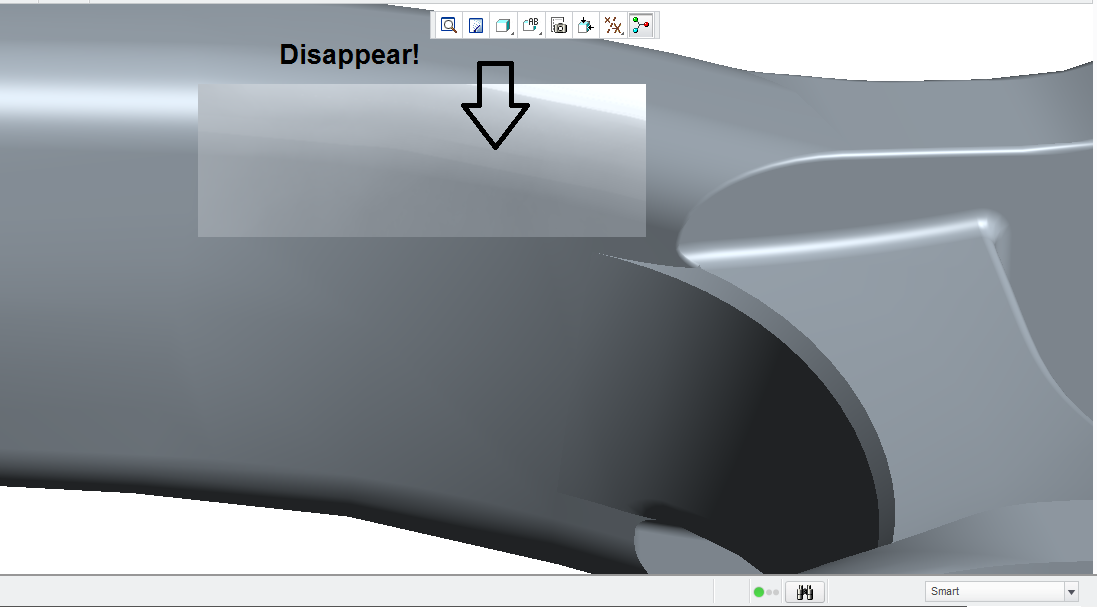

John,
I forgot to tell you, even the reflection analysis tool is not enough to analyze the smoothness of a surface. Sometimes you will need to render the part at their maximum quality to see if something is wrong. This is really frustrating, because you are unable to see the error until the final step, the render thing. Even changing the studio can hide those details (picture 4 and 5).
Patriot_1776
October 2, 2015
The difficult thing is that sometimes that's just a graphics artifact.  I tend to believe the surface analysis tools a little more.  The analysis is showing the issue, but very subtly (sharp edge where the dark line transitions from straight to curved).
