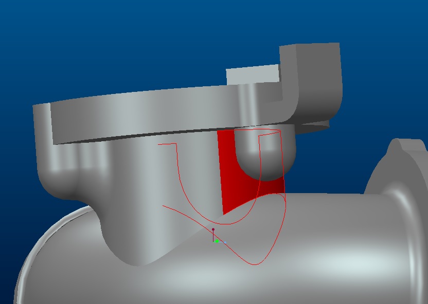

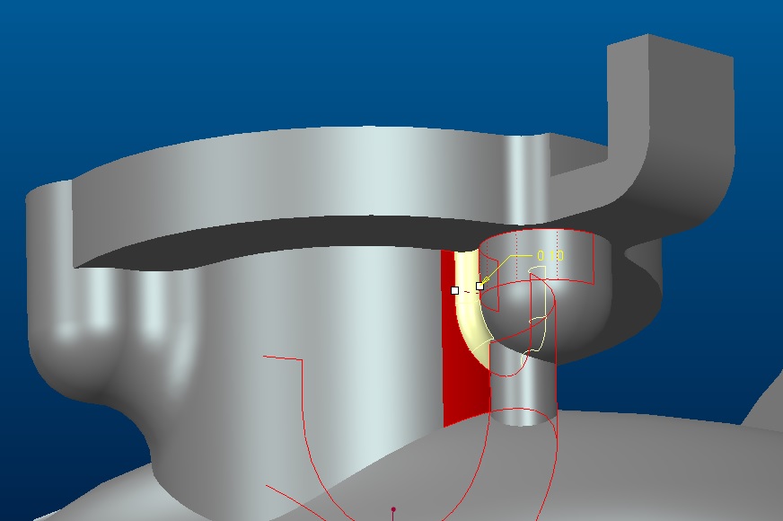

I'm creating a surface to surface round feature from one surface on a flat, to the other surface being a cylinder (diameter).  The cylinder surface shows up as two half, and the end of each half is right next to the surface i'm selecting.  If I do a small radius and it doesn't touch were the half's connect, i'm fine.  When I make the radius what it needs to be, and it goes over that connection line, I get an error.  There are 3 of these flats, 120 degrees apart.  The other two work out fine, because they are not next to were the cylinder connects.  Ids there anyway to make the cylinder as one, or is there a option in the radius creation that would help me.
Best answer by manjunathrv

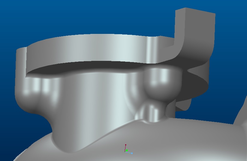

also try to reorder that small vertical cylindrical feature after the round. may be after all the rounds, this cylinder may be buried.

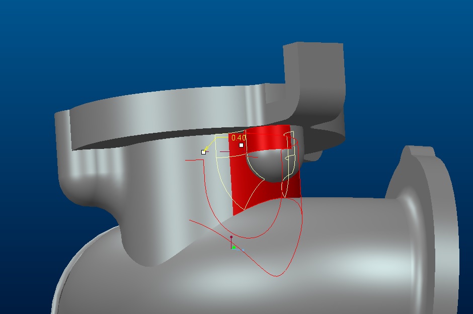

a snapshot would help
jsallemi1-VisitorAuthor
February 28, 2017
Attached are two images, I need the .400 radius. You can see the cylinder line and were it crosses over in image two.

My guess is the failure is being caused by radius of the round being too large.  Try using transitions and also maybe try changing the accuracy.

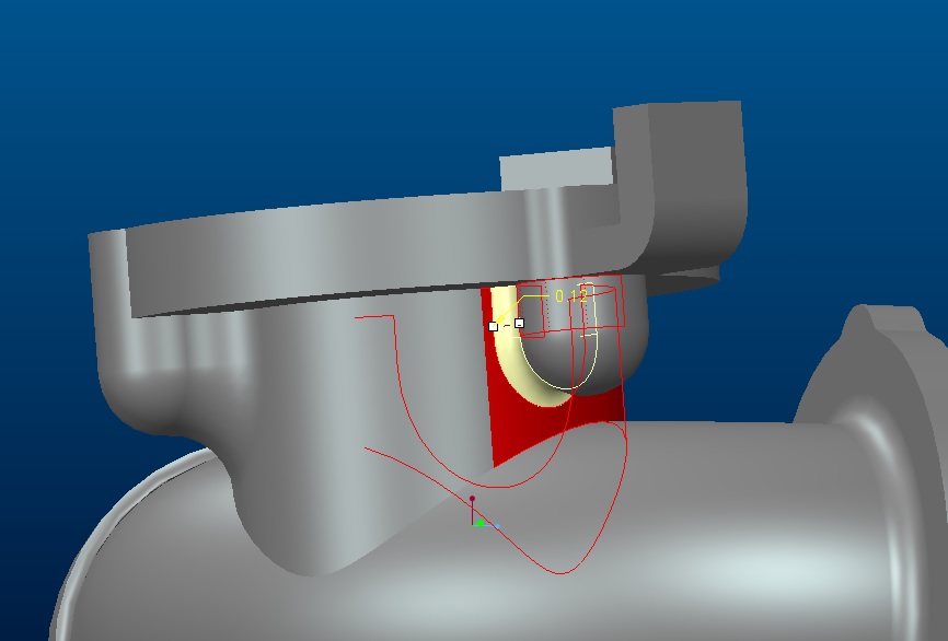

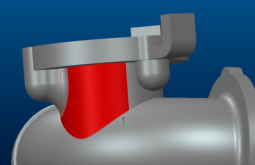

I removed the small cylinder to take that out of the mix of being the problem.  There are two other bosses on this part that accept the .400 radius, you can see one of them to the left in the images.  There reason why it works on the other two bosses, is because it happens to be on the full big cylinder surface and not where it splits in two.
I'm attaching 4 pics to this post.  The 1st and 2nd image shows that when selecting the big diameter, it selects as two half, not one full diameter. The 3rd image shows the smaller radius working, because it's not going over the border of the one half of the big diameter.  The 4th image shows it failing, because the radius is to big to stay on the selected half of the diameter, it's going to the other half (surface) that is not selected.
The problem is definitely that the big diameter splits in two when selecting.  Which is normal for models in Creo, but wondering if there is a work around when either creating the radius, or being able to select that cylinder with one full selection.
Thanks in advance for the help.

It is difficult to provide an exact solution without the model. But try to select the other half surface of the cylinder from you 4th picture. or try to select the edge of the boss only instead surface to surface.

I got it to work using a suggestion from one of the replies on this page. I reorder that small vertical cylindrical feature after I placed the round, and then put an additional round on the small cylinder after it was created.  I originally tried that, but did not get it work before, now it's all good.  See in the attached photo.  Thanks for everyone's suggestions and help.
