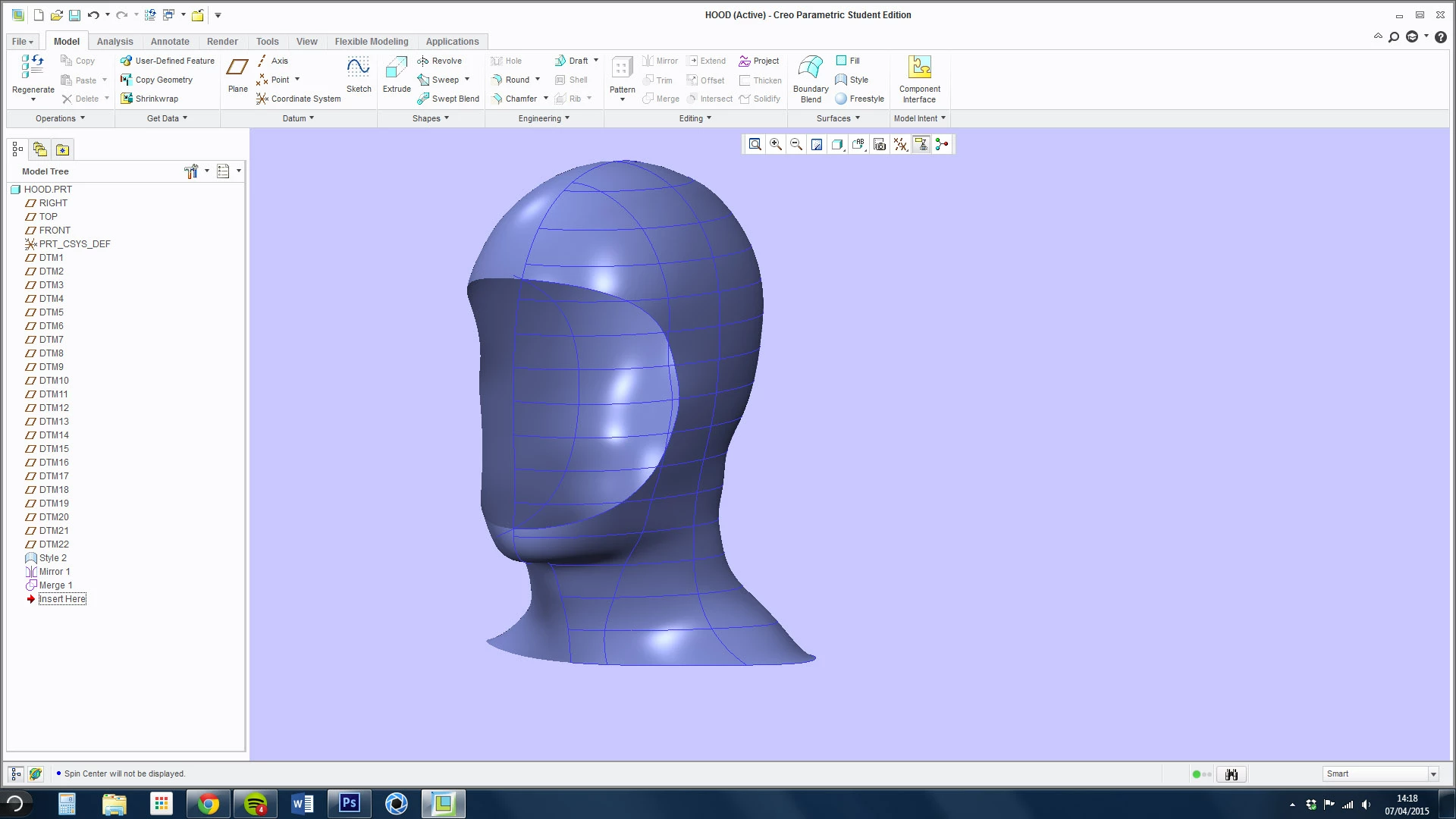

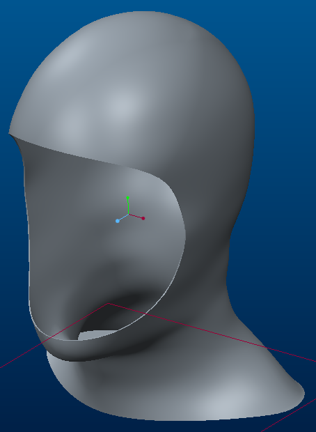

Hi all,
I'm having great trouble trying to thicken what seems like a very simple, smooth surface, with no undercuts in Parametric 2.0. I've tried the various different fits (controlled and automatic) with no success. If anyone could give me any guidance I'd be extremely grateful.
Please see attached files.
Sam

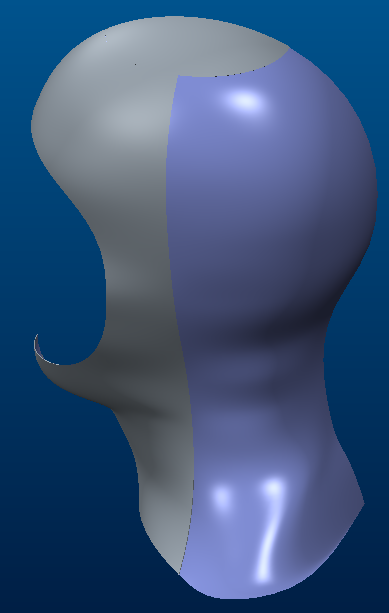

Samuel,
I suppressed Mirror and Merge features. Then I was able to thicken 2 of 3 patches, see grey areas on my picture. Third patch cannot be thickened, because surfaces are self intersecting. Apply Curvature analysis and you will see strange results at the bottom of the quilt (shoulder). Maybe if you cut shoulder off, then the problem disappears.
"How to thicken one patch":
  • set selection filter to Quilt
  • select quilt
  • CTRL+c
  • CTRL+v
  • in dashboard click Reeferences > Details > Excluded Surfaces
  • press CTRL and select unwanted surfaces
  • finish Copy feature
  • select surface and apply Thicken feature (0.5)
Martin Hanak

Samuel,
  • select quilt
  • CTRL+c
  • CTRL+v
Martin Hanak
April 8, 2015
Samuel,
cut 5 mm from the bottom of the quilt and you will get, what you need.
Martin Hanak
