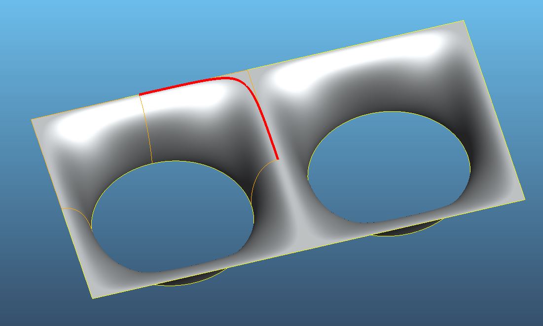

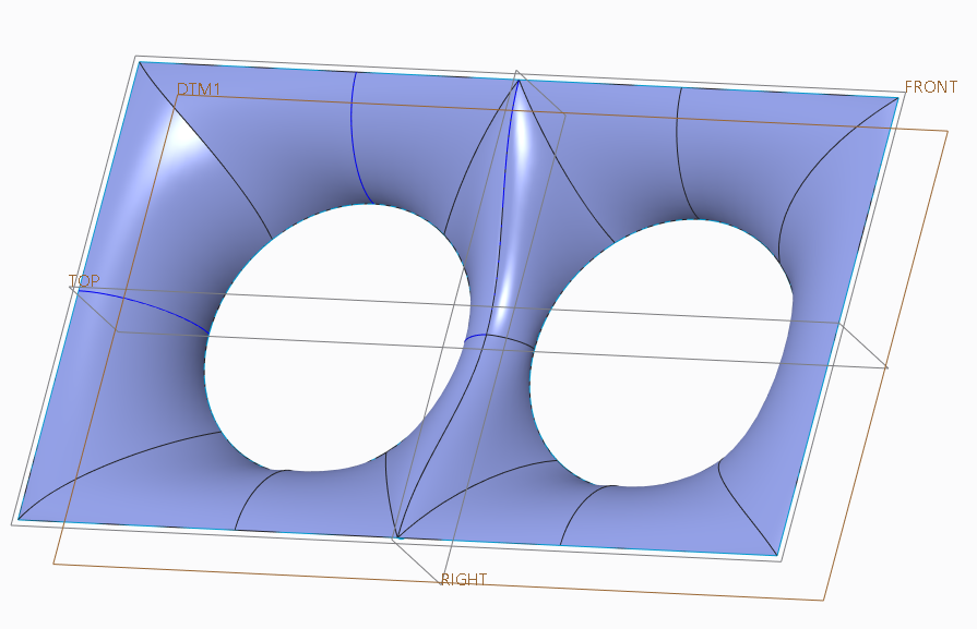

I'm having trouble creating good surfaces for a fan shroud. It is for converging from a rectangular duct to two side by side axial fans.
First problem I am having is getting second order (C2, G2...) contious surfaces. What's the best method for this?
Second problem is creating the saddle like surface between the two axial fans. Have tried various approaches, but no can do.
Attached is an image of the curves and a couple surfaces I have been able to create (though not C2 surfaces). Also attached is the Creo Parametric 2.0 file I've been working in which should make it fairly obvious what I'm trying to do.

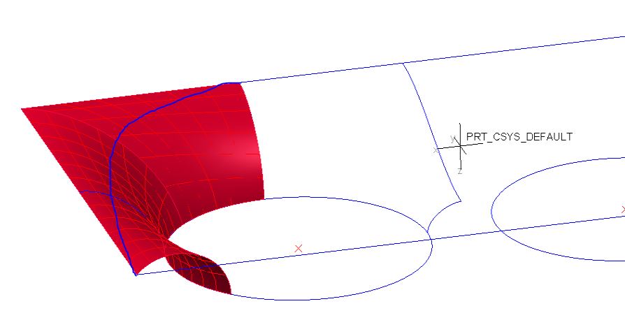

what's about making the top circled and the rest to the edge flat?

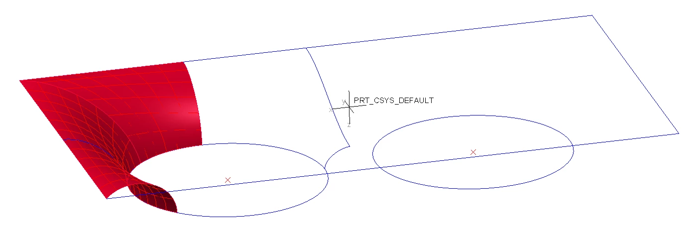

I was recently at a user's group meeting and during a tips and tricks, someone took a section like that and broke it in half to get to four sided surfaces. He also made the two new surfaces continuous to each other. Not my background, but he made it work quite well.

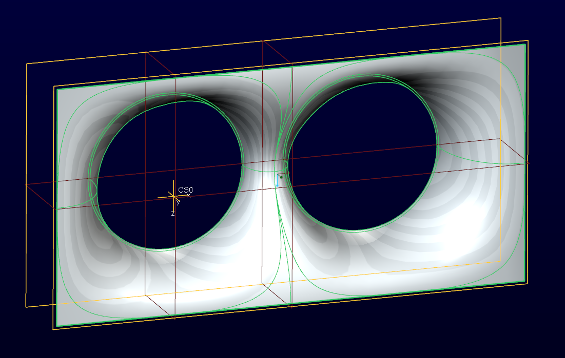

No problem about 5-side surface in style feature. Trouble with boundary blend but there are some tricks. See if my solution can be good. If you need i can give you a solution without style features...

Style surfaces are fine. Thanks, I'll take a look and let you know. Greatly appreciate it!

Ok. You can add more curves to controle it better. Good evening from Italy!

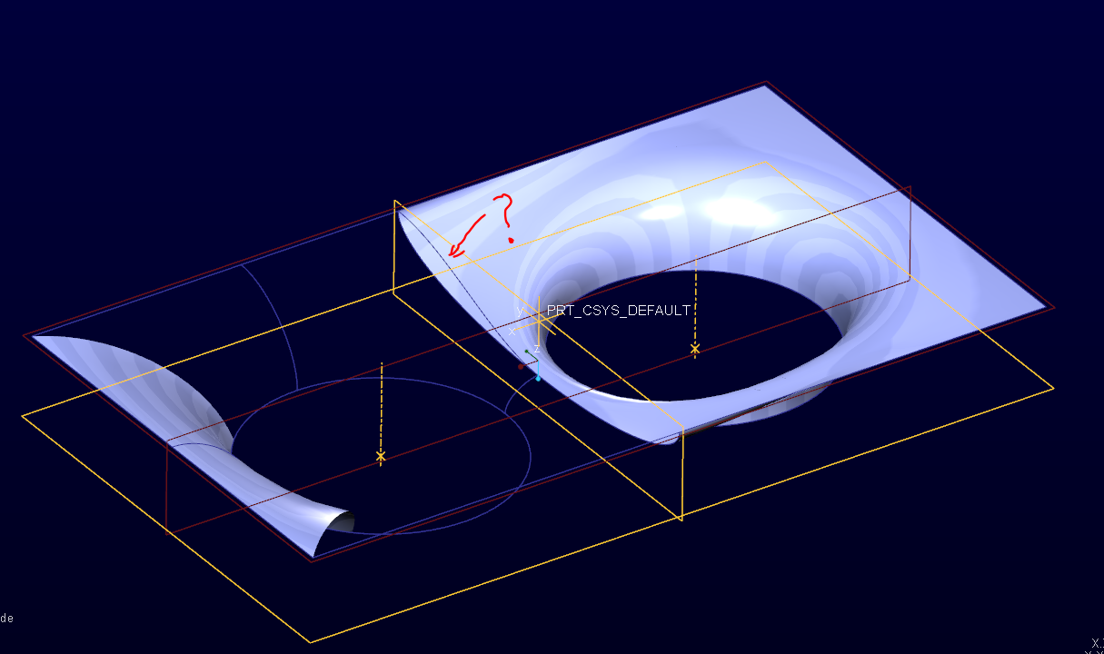

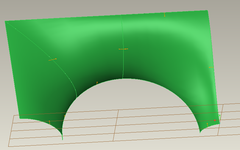

I did come up with this using a C2 round. I am not sure which curve you want to follow (red arrow).
Also, what are you considering for the "saddle"?

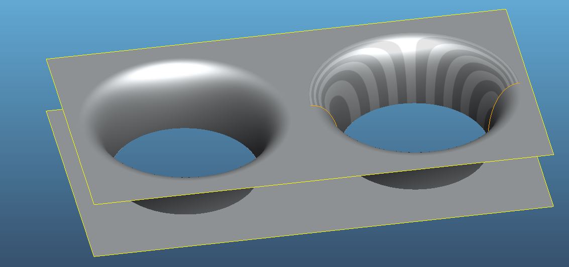

Below is a boundary blend of the face; and a C2 round using a curve (circle) to follow.
What do you want to do with the square corners? This will create a crease. Can the corners have a round where it goes flat prior to corner?

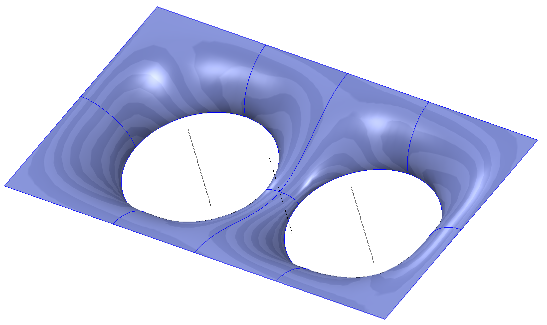

Here an example with a spline close to the edge.
August 16, 2014
That's kinda what I was thinking. Boundary blend with curvature works pretty well for that.

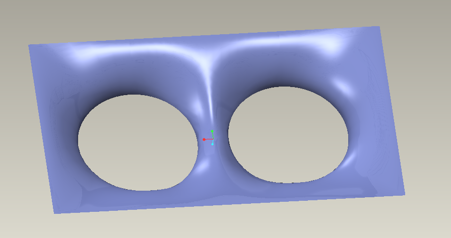

Finally was able to get back to this. Deleted all the curves and surfaces I had tried before. Went in, create a style feature, curves and then surfaces and everything worked perfectly the first time through!
Hmm, wonder why it didn't the previous tries. Maybe referencing non style curves or something? Initial look at reflection curves look good, but not sure about curvature yet. File attached if interested.
