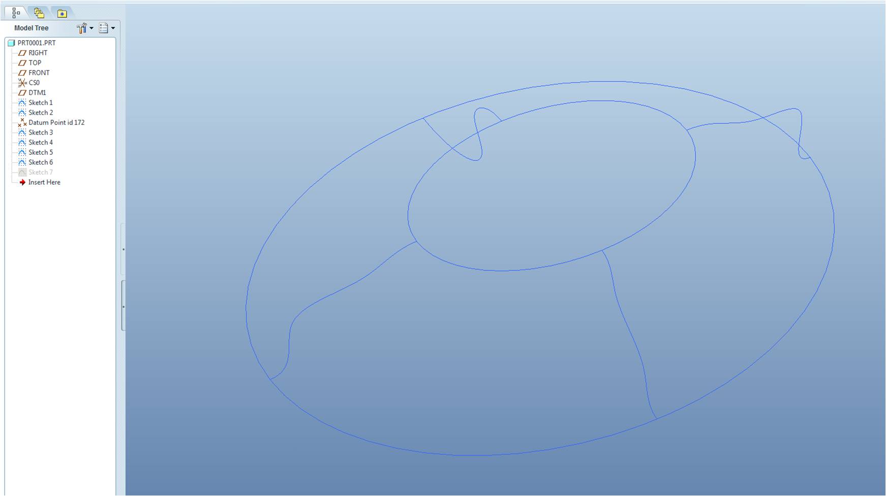

I am having difficulty finding a simple way to create a swept or blended surface with multiple unique trajectories. The beginning and ending sections are both 3D curves (do not lie within plane). The required trajectories are also not tangent or normal to these curves at the interfaces. Below is a simplified example with two ellipses as the sections. I've been doing these types of complex surfaces by knitting multiple boundary blends. For example, below I could create four separate boundary blends with tangency constraints at the interfaces where guide trajectory curves are shared, but this quickly becomes tedious. Hopefully there is a simple way to accomplish this that I have been overlooking...

can't this be achieved in one boundary blend only!
the four trajectories in one direction and the two ellipses in second direction.

Thanks, Rohit. A single boundary blend will indeed accomplish exactly what I need. I beleive my hitch was related to my recent revelation regarding composite curves. I just discovered the cut/paste method to create a composite curve from multiple curves/edges. Why that feature is not available through the standard datum curve interface is beyond me.

I wouldn't use a sweep on that, I'd use a boundary blend or multiple boundary blends. I agree with Rohit, you should be able to do it with one boundary blend.
