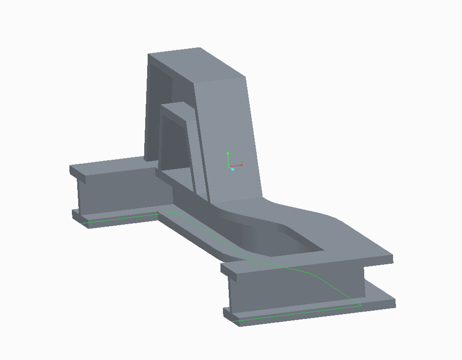

I'm relatively new to using Creo and have been going through a number of tutorials given to me, and have gotten stuck at something that seems fairly rudimentary and I hope I'm just missing something simple.

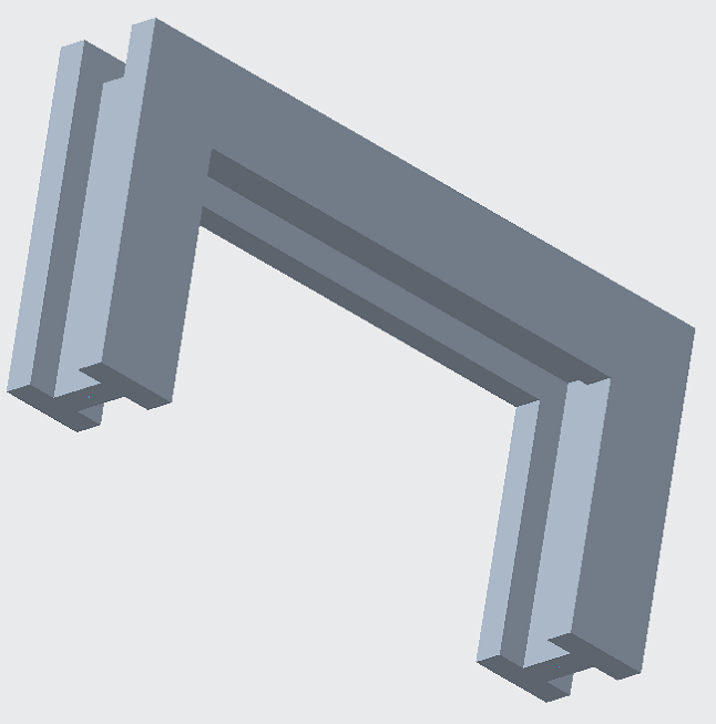

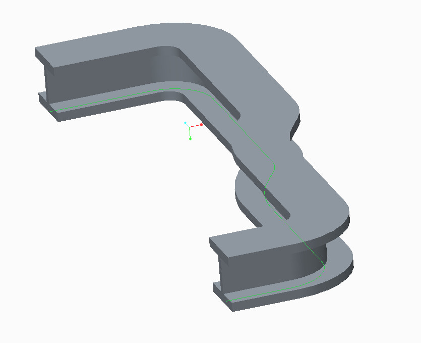

Whilst trying to sweep to generate the second image attached (tutorial model) I get the error message "FRAME regeneration completed with atypical feature or component status. Failed: 1"
While trying the edit the sketch I would receive the error "All the entities must be tangent". I eventually was able to generate a swept model by placing larger radius's on the problem sections.
I've had a look at both mine and the tutorials model, and I can't for the life of me figure out why theirs is able to sweep with the 90 degree bends and mine is not

Original model contains Sketch 1 with two arcs with radius 25.
Sketch 1 in your model contains wrong radius value 1 related to one of arcs. Modify it to 25 and you will get proper sweep geometry.

I've attached both the tutorial model, and an attempt done by myself to get the model to sweep
I attempted to use the allows section to be changed based on parametric references or relations along the sweep icon however I found myself unable to make it generate.
