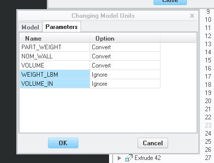

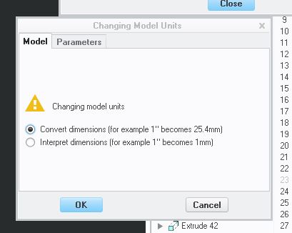

When you set the new units you are presented with this dialog:
Click on the "Parameters" tab, There you'll find a list of parameters that are defined with units in the current unit system.  Look for any unit driven parameters that you need to remain in their existing units and set them to "ignore".
In my case, the first three should change with the unit system, the other two I need to stay in pounds & inches respectively.
September 4, 2015
Doug,
Can that get set as the default so every time someone switches it would remain IGNORE'd? It resets every time for me. I'm reworking our start parts and would like all future switches to be ignored.
Luke
September 4, 2015
No, as far as I know, you need to review that list every time you change units.  In my experience, a unit change doesn't happen that often

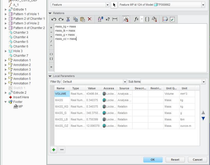

Maybe I am missing something here, but why not just drop a mass properties feature into the footer and define your alternate parameters there.  User parameters defined in a mass properties feature can have units assigned and will retain their units when the units of the model are changed.  Being in the footer means that the mass properties are automatically calculated at the end of the part regeneration.  I added this to all of our start parts a while back so it is already there.  For the transition, I had a mapkey set up and also passed out a set of instructions so the engineers could fix any problem files in their current projects.

When you switch units, the default units of the model will change, but the calculated units are defined in the parameters, so Pro|E / Creo will automatically convert the exist value to the requested unit of the user parameters.
Now that I read that sentence again, it does sound a bit confusing...
The attached PDF pages are from our old WF4.0 work instructions (I cut out the non-essential information).  The same method works for Creo with one minor change: before you set the units of a parameter, you need to define the type of unit in the preceding column (if you look at my previous post, you can see where the column before the units says "mass").  I am guessing that PTC did this so you do not have to scroll through a list of 30+ units.
As for calling the units, you need to call &<parameter>:<feature ID number> or &<parameter>:FID_<mass property name>.
