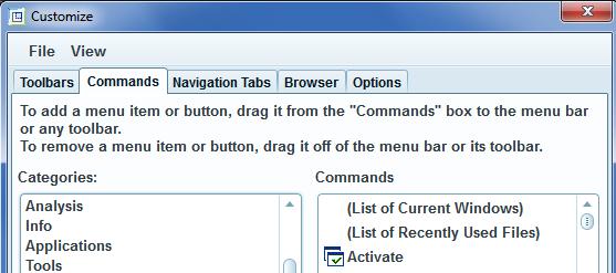

Hey Guys,
There is also an option under Tools>Customize that allows you to place a list of current windows on your menu bar; see below: (List of Current Windows)
November 29, 2012
Hey,
Is this also for creo2.0, because I don't find it for the moment.
Best regards,
Christophe
