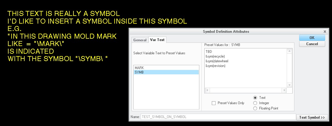

Hi
I'd like to visualize a symbol inside another symbol.
I use a symbol which is a note with several variable texts inside.
It's useful for me to customize the note in each drawing .
In the middle of this text it could be fine for me insert a standard symbol
e.g. inside the annotation symbol this is the text :
     THE PART SHALL BE MARKED WITH RECYCLE SYMBOL &sym(recycle) .
But it doesn't work. ( I have the symbol in memory).
Any idea ?
Thanks Pier

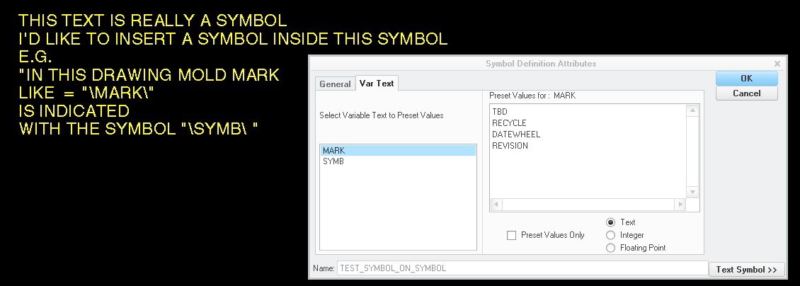

Anyway let me share two pics in order to explain my need.
Pier
November 27, 2015
Confirming we don't have symbol -> note -> symbol recursion.  One approach that might be suitable to you is including the geometry+text of the sub-symbols within the main symbol, under a grouping.  Then the user placing the symbol could select the group that includes the desired sub-symbol.  Another approach that might be useful, but seems less likely, is placing the second symbol as offset to the first.
