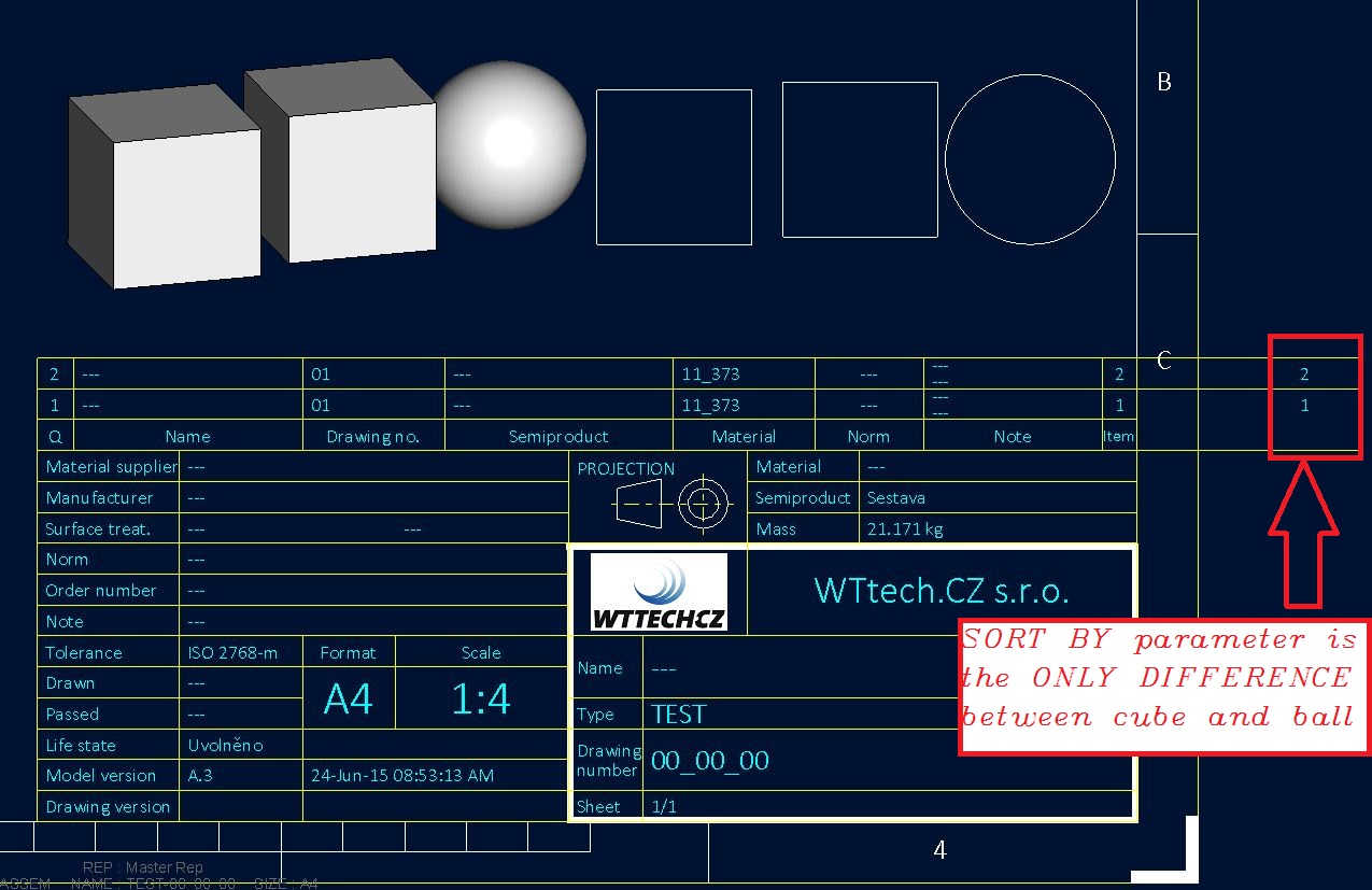

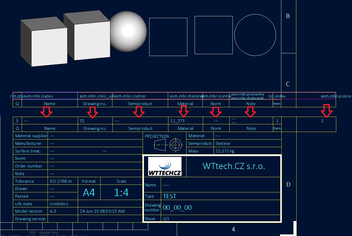

In the past l discovered similar problem.
It occurs when, ALL parameters that inputs into BOM table where the same for more than 1 part.
See the picture bellow. 1st part is a cube 2nd is a ball, but all parameters are the same in both parts.
From this reason l set help parameter POZICE (position in english) and set SORT BY as following:
&asm.mbr.pozice forward
&asm.mbr.pro_mp_mass forward
When POZICE is the same for more parts, SORT them based on MASS.
My recommandation are:
- check parameters value in your parts ---> give them different value
- check your repeat region filter
- check your SORT BY parameter (try to sort via some other parameter)
My testing assembly is attached. Try to change parameter pozice and all other keep the same.
