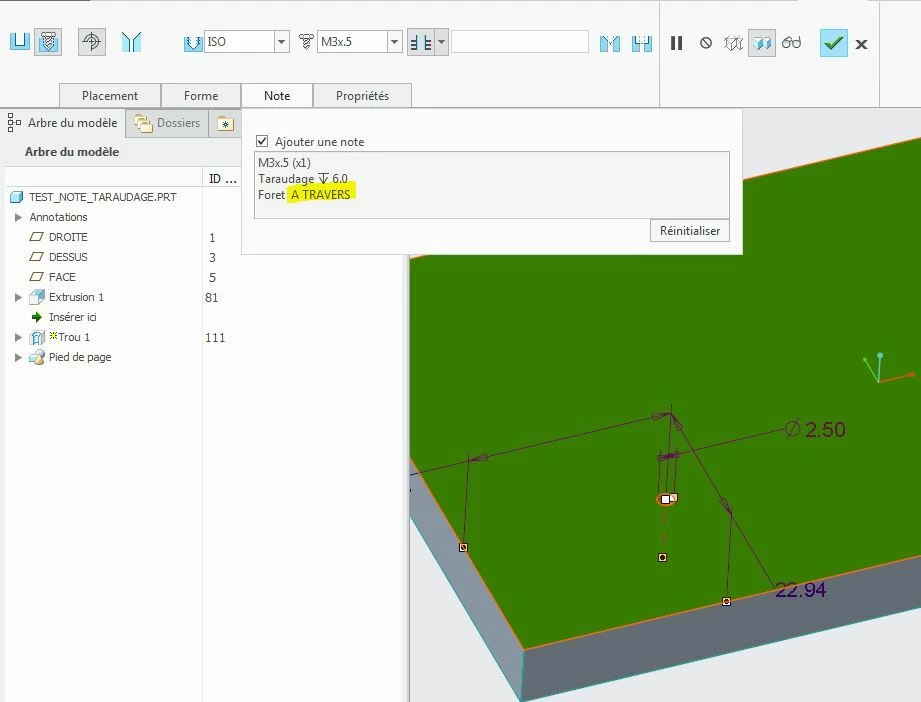

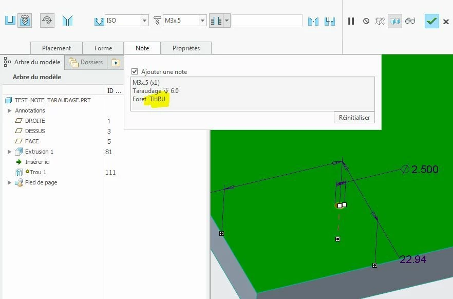

Hello everyone,
Since Creo 4.0 M030, when creating a hole through a part I noticed the note telling it's going through the part change to english from french. Since M030 it's written THRU instead of A TRAVERS. Any idea to change this ? All the rest of Creo is still in french as expected. Below the same file. The first picture shows the note with M040 and the second with M020.

In fact, my hole tables work perfectly fine with Creo 4.0 before M030. The problem started with M030. If I open a file with M020, it's fine. The same file opened with M030 et M040 shows this problem.

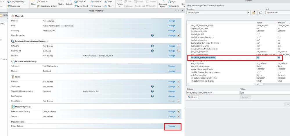

RaphMORIN16-PearlAuthorAnswer
January 24, 2018
Finaly got the answer from support. Since M030, there's a new option in part DTL file called hole_note_param_translation. I can adjust this option in my templates... But in all the parts I made before I have to set this new option to get the correct translation ! Smiley Mad
