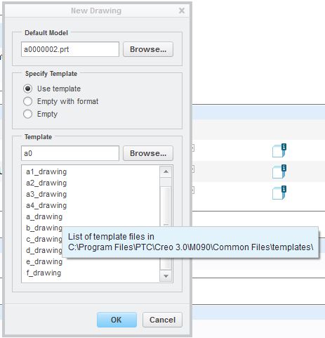

Capture.JPGHow do you change the directory that list your drawing templates?
I do not have permission to save to the default location.
Best answer by MartinHanak
set config.pro option start_model_dir
MH
6 replies
August 29, 2016
pro_format_dir set in config.pro set to your local folder that has the templates in it.
pro_format_dir c:\ptc_user\user1\formats
bjoyner1-VisitorAuthor
August 30, 2016
Ben
      Thank you for the response.   I did try that, but it seems to keep pointing to
the location shown in the original screen capture.
I did however get my permissions changed so that I can save to that location.
August 30, 2016
The system will still point to the system template folder for drawings. Maybe this needs to be an enhancement request.☺
If you select Brose, it will open your defined folder for the templates.
I would NOT recommend modifying or saving the drawing templates back to the system folder as they get overwritten/deleted when you upgrade!
August 31, 2016
MH
August 31, 2016
Thank you.  That seems to have resolved my problem.
The description of the option is a little confusing though.
Not sure what other things it affects but it does point my template list to the desired location.
Thanks again !
