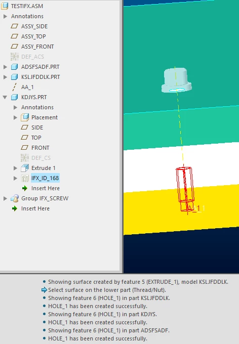

Is there an option so that the threaded hole created by creo isn't hidden by default? The clearance holes are not hidden.

I have tested this in Creo 4.0 M030 right now. All holes are visible.
Maybe you have a Layer configuration which hides all holes.
Please create a hole feature without IFX and check if it is visible.
IFX has no functionalty to hide created holes. Don't know if there exist a Creo option to do this.

I believe you are right. It looks like it is just a layer status issue with cosmetic features
