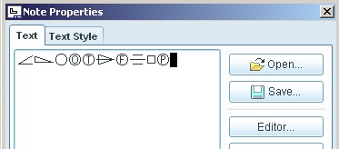

To insert text symbol directly from the keyboard (text symbol as a font): press CTRL+A when in a Note Properties window.
To come back to standard font, press CTRL+B.
In the exemple below I typed "azertyuiop"

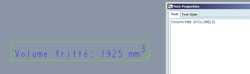

To round the value of a parameter called in a note, add [.X] after the parameter name, X being the number of decimals.

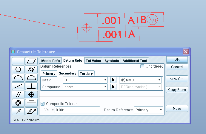

Anyone know how to create the Feature Control Frame B below?
http://www.kxcad.net/ugs/SDRC_I-DEAS_NX_series_Help_Library/des_ug/graphics/s8Dmgf2dobo.gif
Jul 9, 2012 7:32 PM UTC
Hi Antonius...
That's called a Composite Tolerance. from the Datum Refs tab, select the radio button for Composite Tolerance. See below. If you need help with the other stuff (diameter symbols, etc) just let me know.
Thanks!
-Brian
