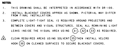

Dear all,
Sorry for push up the topic but i have a similar question on this subject.
I try to find a way for create balloon in a text with using parametric like GD&T.
I find nothing how to do that without use balloon and use related to object.
Any idea ?
June 24, 2013
Hi Sebastien...
Can you draw us a simple image of what you're trying to to. I'm not quite sure from your initial message.
Thanks...
-Brian
June 25, 2013
Hi Brian,
I want to get something like that.
Balloon inside a note !
Seb

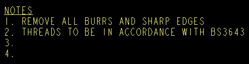

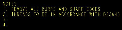

I made a note and saved it for future use. The note looked something like this:
All well and good. However, when I inserted a note from file and selected the note I had saved, this is what came in:
Spot the difference?
The word 'NOTES' is no longer underlined. How can this be?
Am I doing something wrong, or is this a bug?
Whilst on the subject, I know how to split up notes using {1:xxxx}{2:yyyy}, etc. so different bits can be formatted differently. However, if I format one of the text segments as Centre Justified, they all change. Likewise if I make just one Left Justified. Is it not possible to have different justifications in a single note?
John
WF4, M220
July 11, 2013
No idea about the underline, it just falls off!
For the justification though, if you look at the text style box it is split into 'character' and 'note/dimension'
Stuff in the character area can be applied to individual portions of the note, whereas stuff in the note/dimension area is applied to the whole note - or at least that is my understanding of it (doesn't help you)
Justifications can be applied to individual cells in a table but not lines in a note
July 11, 2013
Thanks, Charlotte,
I think I twigged where the underline goes: It is saved as a .TXT file, which is associated with Notepad, and does not support formatting such as underline. I don't know whether using Wordpad might help. I'll have a play one day when I have time.
As far as the Justification goes, shame. It would be good to be able to create notes with varying justification, although the comments above regarding Notepad would probably apply equally.
Ah! Well, never mind...
John

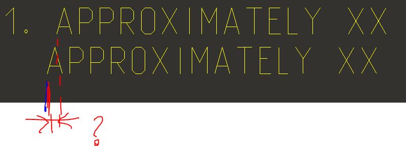

March 26, 2014
Creo2 drawing notes image:
Notepad notes image:
Hello Team,
Am just trying to fix the alignment problem with in Annotation->Note
Why two lines are not getting aligned in creo 2 like how in Notepad.
Your ideas will be really helpful.
Dale_Rosema
March 26, 2014
Naveen,
Welcome to the forum. PTC is in the process of creating an editor where "What you see is what you get" per this product suggestion. I am not sure if this is available yet, or if it is going to be in Creo 3.0
Thanks, Dale
http://communities.ptc.com/ideas/2059#comment-7802

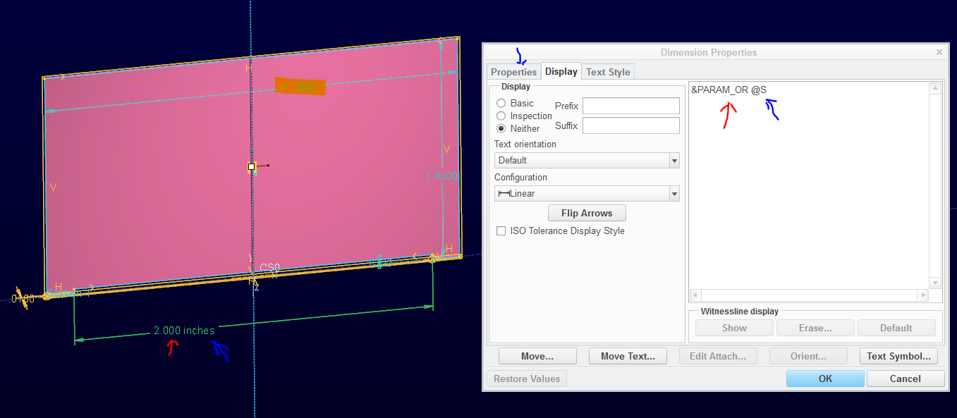

October 23, 2014
Please suggest me what is the syntax for overriding added dimension with parametric dimension.
Ex: Added dimension is 45 degrees, i want to replace this with driven dimension 60 degrees.
Thanks in advance
Sudarshan
18-Opal
October 23, 2014
Although this is frequently used for notes, this sounds like a dangerous thing to want to do for dimensions. Could you explain why not just correctly display the dimension in the model? Is it a matter of orientation?
October 23, 2014
There really is nothing worse than overwriting dimensions for the sake of saving a little time. There are only very few instances when this is sanctioned in general, one of which is table dimensions and the other is broken views.
You cannot change the properties of a dimension to simply overwrite the value with a parameter in the model (driving dimensions). But you can change the name of the dimension and and have it show this in the dimension. You can then add a parameter.
Obviously the panel cannot be 1.75 inches wide and the slot be wider at 2 inches. param_or is set to 2.0 in relations; inches is the name of the dimension in properties.
However, if you have a driven (drawing) dimension, you can use the @O&param_or to overwrite the dimension on the drawing.
Please don't do this unless you have a very good reason!
