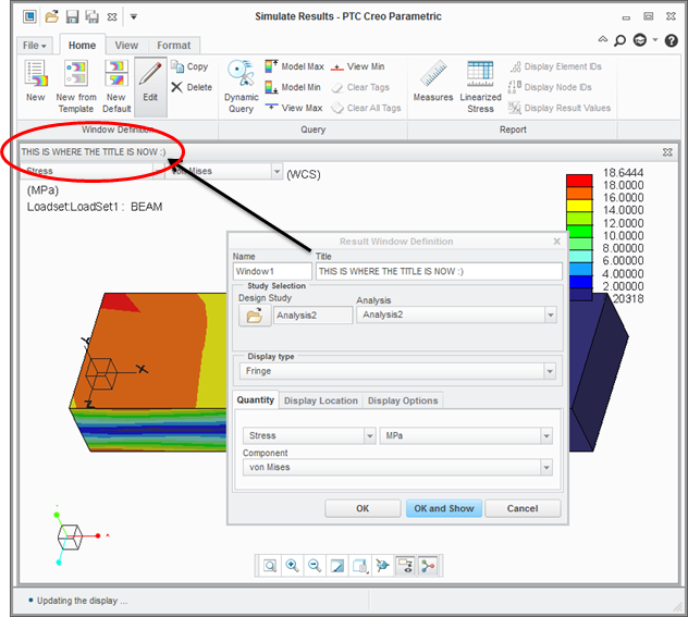

Does anyone know if there is a way of making the title of a results window visible in Creo 3.0 Simulate (M020)? This was possible easily in Creo Simulate 2.0 and now it does not do it. Is this a bug or is there an option I am not ticking?
Many thanks.
Best answer by 346gnu
Colin,
The short answer is ... no.
In Creo 3, the title is only where I have indicated.
Your options are limited to

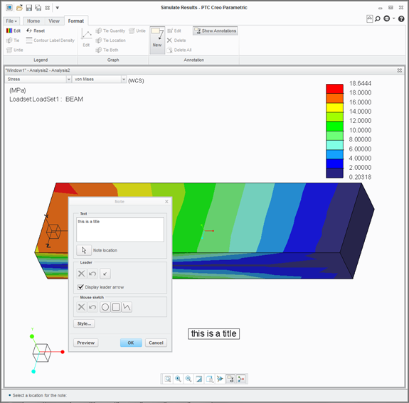

1. Annotating in the software
2. Grabbing the window and annotating using the drawing tools in Excel, Paint.net, Paintshop ...
The image below is using the annotations in the software
However, I am not satisfied with the control one has over the print function from within the s/w and life is much higher resolution using 3rd party grabbing and sizing tools methods.
Regards
February 23, 2016
Colin,
Does this help?
Titles are no longer along the bottom of the window
Regards

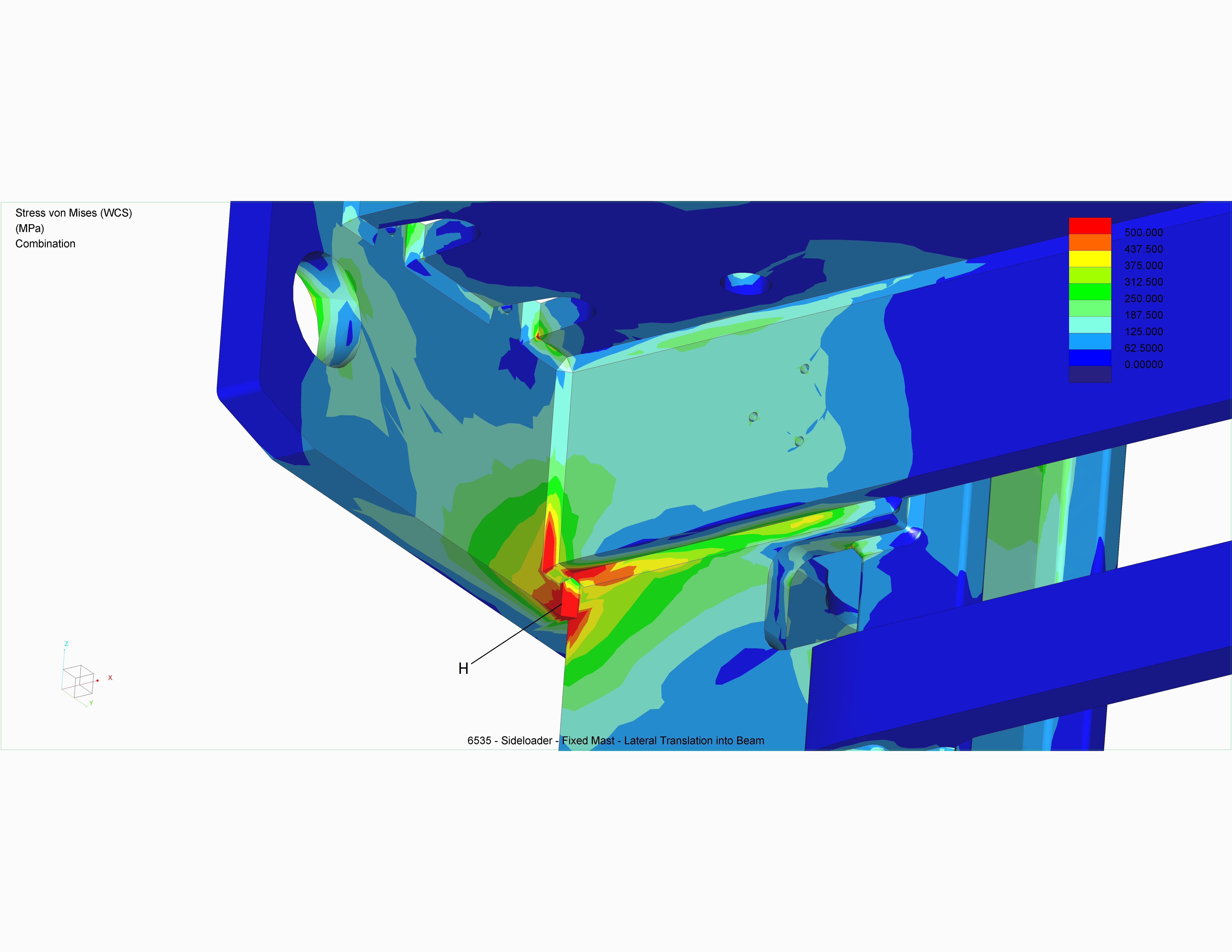

February 23, 2016
Charles
Thank you very much for your response.
What I would like is for the title to be in the window so that when I "print" a plot it has the title in it, see Creo 2 example attached. Is there any way to achieve this in Creo 3.0?mast_impact_2.jpg
346gnu13-AquamarineAnswer
February 23, 2016
Colin,
Regards
