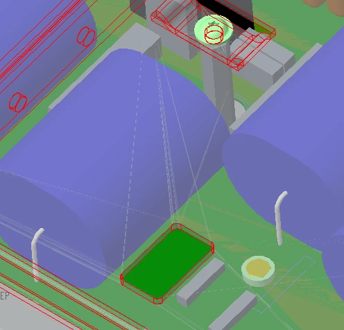

I am trying to make one plate as transparent in my assembly. But it resulted in improper way. I am getting lines on the part like the transparency looks like shattered glass.I have attached the image. Help me out. Thanks in advance.

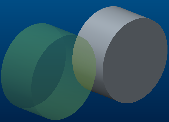

transparency problems can be related to graphic card. What graphic card is installed in your PC ?
Example:
  • model on the left side is colored using transparent color
  • model on the right side is colored using opaque color

Thanks for your reply i think its standard VGA graphics card.graphic card.PNG
December 9, 2016
you graphic card is not supported. Creo needs dedicated graphic card with support of OpenGL 4.x
