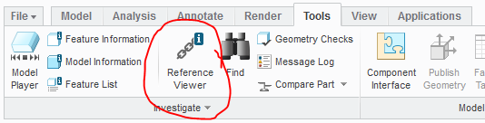

Paul Imm‌, take a look at the reference viewer.  It should show you what external references still exist.

Thanks for your suggestion.  I knew there was a reference viewer, but didn't know where it resided.

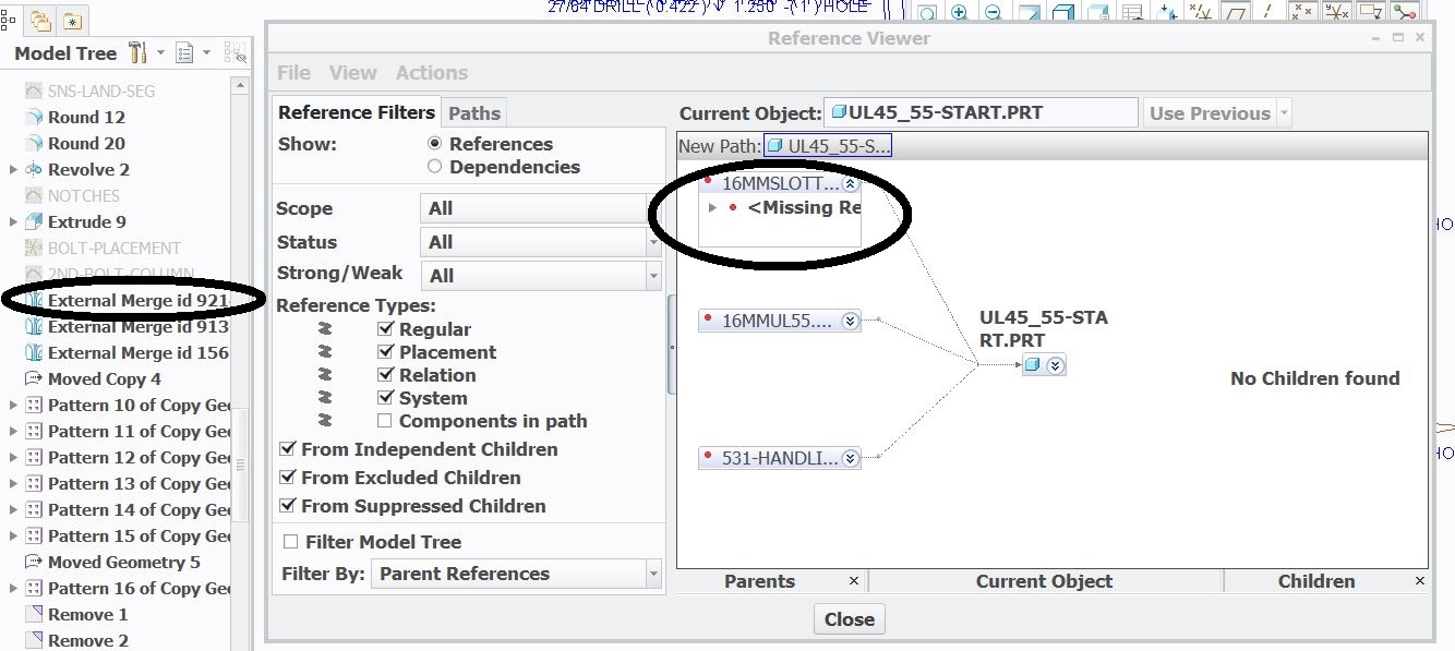

When I broke the link to update the inserted component it still sees itself as an external reference.
Would I be correct to say that a start part can't include any type of a merge, even though the external reference is broken?  Would this be the same with copy geom?  Would there be any way around this?
I'd say that's probably a pretty good assumption.  If the reference viewing list other models, then "under the hood" there is still a link.  I would suggest you avoid any type of external reference features in a start part...
