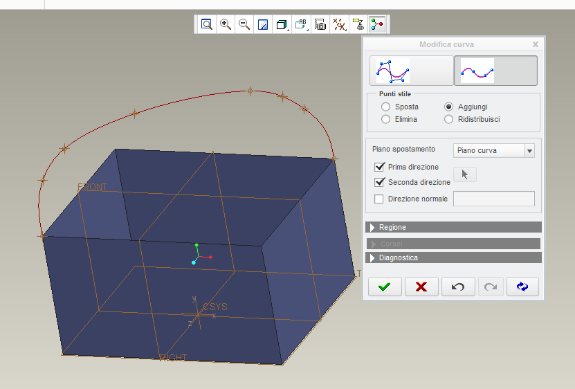

You can add additional points to spline and then you can tweak curve...Capture.PNG
