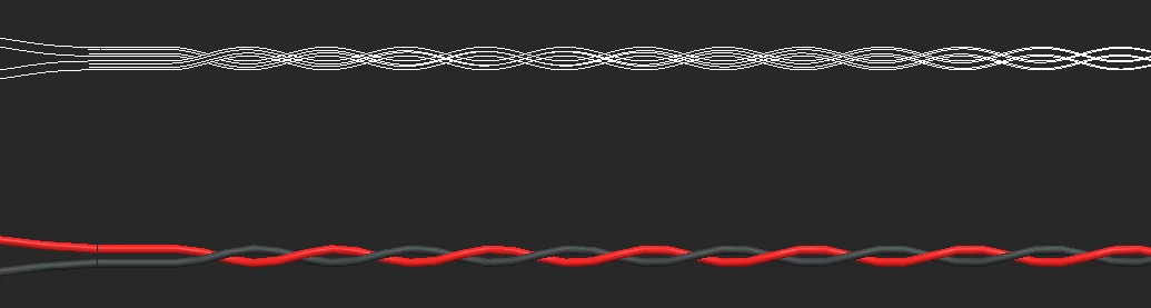

Hi all
I'm currently having an issue with drawings of assemblies that contain twisted wires (which I'll be making a lot of)
The wires display perfectly fine with a Shaded display, but when I change the display style to "No hidden", I get a lot of extra messy lines that should not be visible. The tangent edges setting and all other "View Display" settings do not have any impact on this. I can't seem to get a clean line drawing of these twists! I know that rendering issues like this happen with interfering parts in assemblies, but the wires are separate and there is no interference.
A picture is attached of the same wires in "Shading" mode and "No hidden" mode.
Any ideas on how to remedy this? Or am I doomed?
Thanks!

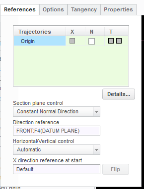

I solved it this way.    I went and redefined the first of the twisted wires and changed Section plane control to constant normal direction and chose the FRONT datum plane as my direction.   It appears as though it is the end point of the circle that was flowing around causing the little tangent line to display on the drawing.  but there is still some issue with the hidden lines not all displaying properly.

Hi, it is possible to share your part (we can try to investigate your data)
(do not forget add the information about ProE / Creo version - datacode)

Its likely do to interference. Creo has a hard time drawing lines when geometry overlaps. When you think about it the Math is very complicated.

Thanks for the reply. There is no interference though. I have seen the problem with overlapping geometry before, but I've checked this model over many times. It's two separate sweeps, twisting around each other, but at no point do they intersect anywhere in the model. The math is still very complicated in this situation, so it's probably a similar issue, but no interference happening.
August 13, 2015
It looks like it may be an accuracy situation. I took your model and changed the accuracy as shown to .00005 and then went to the drawing and it made half of the unwanted lines disappear. But if I tried to make it an even smaller accuracy then it wouldn't regenerate it at all. Hope this helps with some more information.

Maybe try setting accuracy to absolute and setting a value of .0005 inches (or .01016mm)? It's worth a shot.
August 13, 2015
Whatever it is, Creo 3.0 M050 apparently fixes it.  When I open the drawing I can see the extra edges, but as soon as I make any changes the extra lines go away, and I can't make them reappear.
