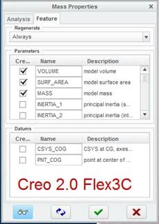

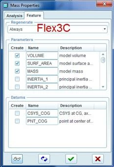

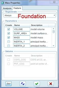

I am working on a military project were all parts are required to have certain parameters assigned to them, one being UNIT_WEIGHT. After assigning a density to a part, what do I need to do to have the weight parameter automatically populated?
17 replies
May 11, 2012
I fairly sure it is BMX.
Tim McLellan
Mobius Innovation and Development, Inc.
May 11, 2012

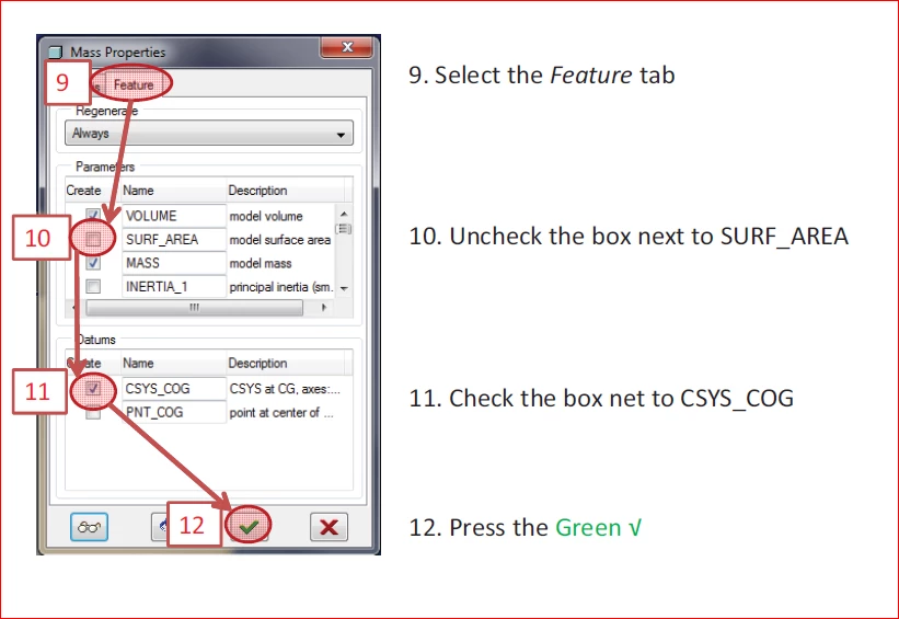

Yes it is BMX. I went round and round with a friend on why this didn't work for him. PTC finally told him he needed behavioral modeling to do it. I just had him send me his start part, created the feature and sent them back.
If you have one license of BMX then you can create this feature and the people without it can reap the benefits.
