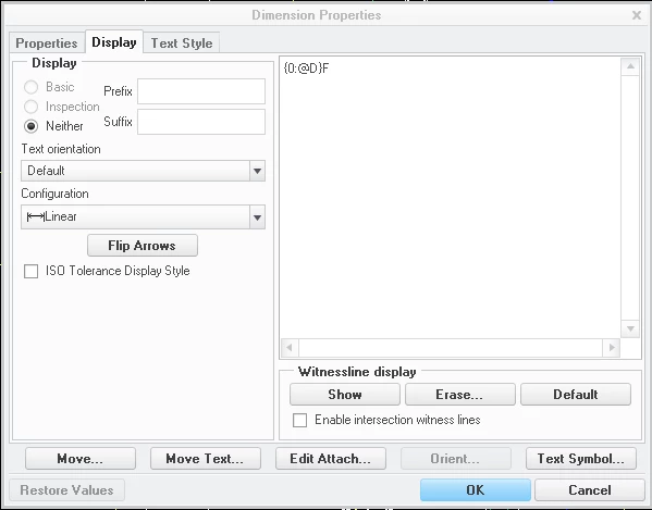

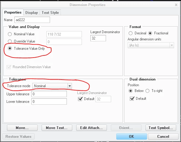

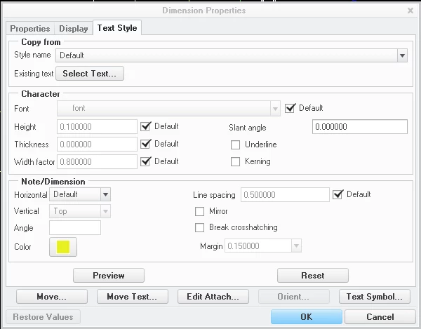

I am getting unwanted breaks on witness lines in Creo's drawing mode.  Not sure why they are occurring. I've tried clearing all breaks but that doesn't appear to work.   I made the dimension value an "F" by selecting "Display Tolerance Value Only" in my settings and by selecting "Tolerance Mode: Nominal".  This issue seems to only affect horizontal dimensions.  Please see attached screen clips for my detailed settings.  Can somebody explain how to fix this? Is there a better way to change a dimension to a letter?
FYI, I am using Creo 2.0.
Best answer by JonathanHodgson
I haven't seen the break issue, but as for displaying a (created) dimension as a letter instead of its value: replace the default @D (Dimension value) with @O (Off).  Although your 'tolerance value only' approach works, too...
A slightly more parametric way (depending on what you're doing) is to change the name of the original (shown / model) dimension from e.g. d123 to F, and then replace @D with @S (Symbol).  You can then use and show values of F in a family table.

@O worked right away.  Thanks for your guidance!
