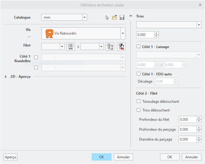

Hi all,
I create a custom catalog in IFX.
this catalog is a legacy family table. first, I add all the instances in the .dat file, like this:
SCREWTYPE 4
UNIT MM
SURFACE 226
AXIS 267
CBSCR DIN974-2 R1
INFO Vis Rabourdin
SYMBOL STRING DN LG B S DK K DG P
INSTANCE STRING DN LG B S DK K DG P
1021_5_08<VIS_RABOURDIN> M6 6 16 8 3 9 4 5 1
1021_5_10<VIS_RABOURDIN> M6 6 18 8 3 9 4 5 1
1021_5_12<VIS_RABOURDIN> M6 6 20 8 3 9 4 5 1
1021_5_14<VIS_RABOURDIN> M6 6 22 8 3 9 4 5 1
1021_5_16<VIS_RABOURDIN> M6 6 24 8 3 9 4 5 1

FAMPRT vis_rabourdin
#FAMTAB M<DN> d44 d47 d48 d56 d45 d46 d43
but it's worse.
I have CREO error message :
'vis_rabourdin' ne peut pas être récupéré.
Aucune donnée valide trouvée.
DN vis_rabourdin.dat
(it saying that vis_rabourdin cannot be retrieve)
and the IFX pop-up is empty for all catalogs!
does someone can help me to understand what is wrong please?

Best answer by OliverGräbner
Hi Ronan,
I had a look at your example. Everything seems to be correct.
Please move your generic to a archive (set search_path) an try it again with my attached files.
I have added the following examples:
  • all famtab instances in the *.dat file
  • Mapping to the generic with ALL fasteners
  • Mapping to the generic using MUST filter. Only show DN=6
  • Mapping to the generic using NOT filter. Show all DN but not 6
Find more details in the HelpCenter
Oli

Ronan14-AlexandriteAuthor
January 10, 2018
thank you again Oliver, everything works fine with your files.
best regards
Ronan
