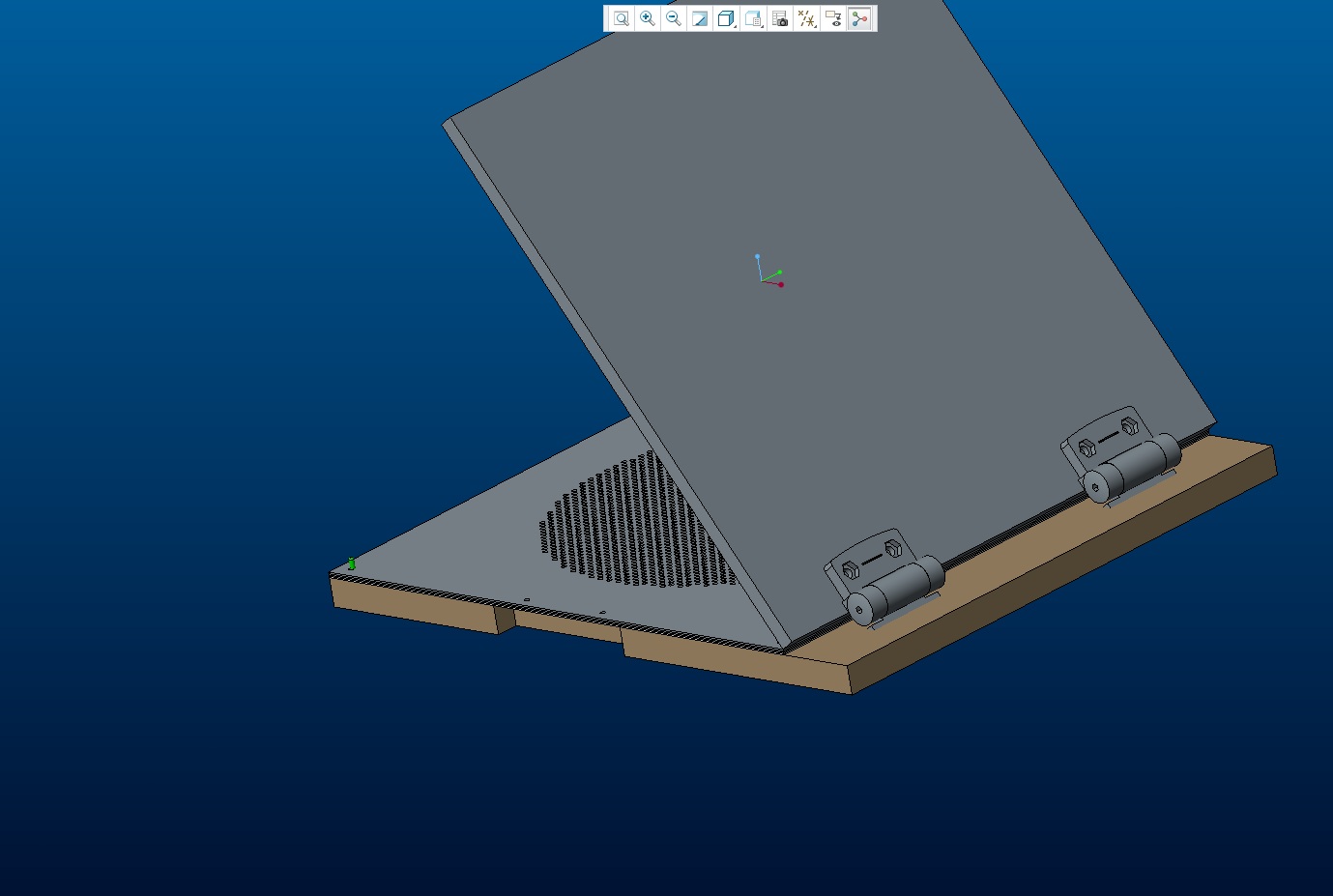

Hello
I have a piece "hinge" and i want to constrait different at angle
is posible to reconstruct geometry of hinge ?
i want to  constrait base plate of suport with base plate of hinge
the hinge is step and no have posibility to constrait to one another i reffer to hinge

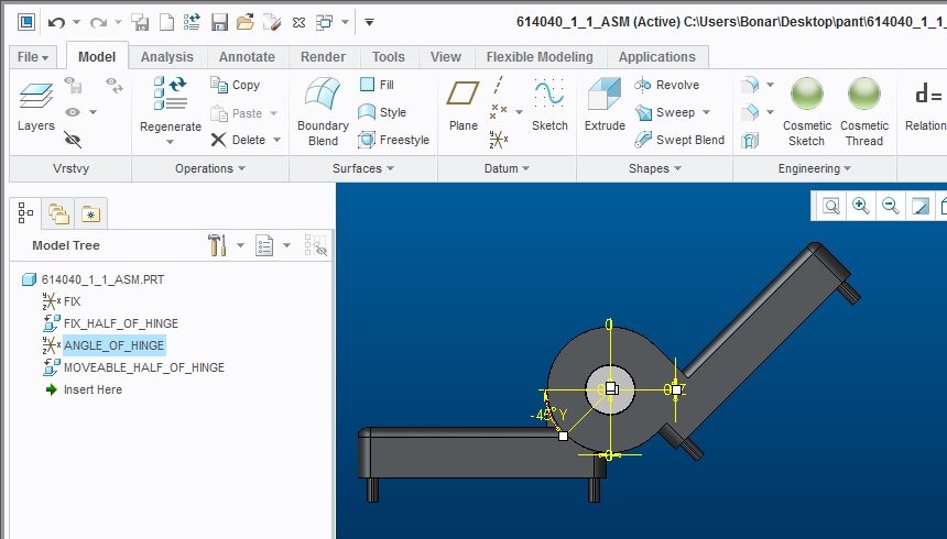

Hello bogdan catalin
my praxis about this proble is following:
Methode:
1. download desired STEP model
2. open and "resave" model as IGES with FLAT STRUCTURE - select coordinate system in axis of hinge
3. open IGES file - investigate imported geometry with import data doctor and delete half of hinge, that should be moveable
4. create coordinate system related to that one in axis of hinge - use rotation around hinge axis
5. import the same hinge again and use "rotated" coordinate system to import
6. investigate second geometry with import data doctor and delete all parts of hinge that should be fix all time
Result:
A) You can change angle of hinge with coordinate system edit value.
B) Whole hinge is in one part (all parts got one ordering number)
C) All hinges parts are in one part ---> good for BOM tables
It looks comlicated, but works fine for me...
See attached file...
Regards
Milan

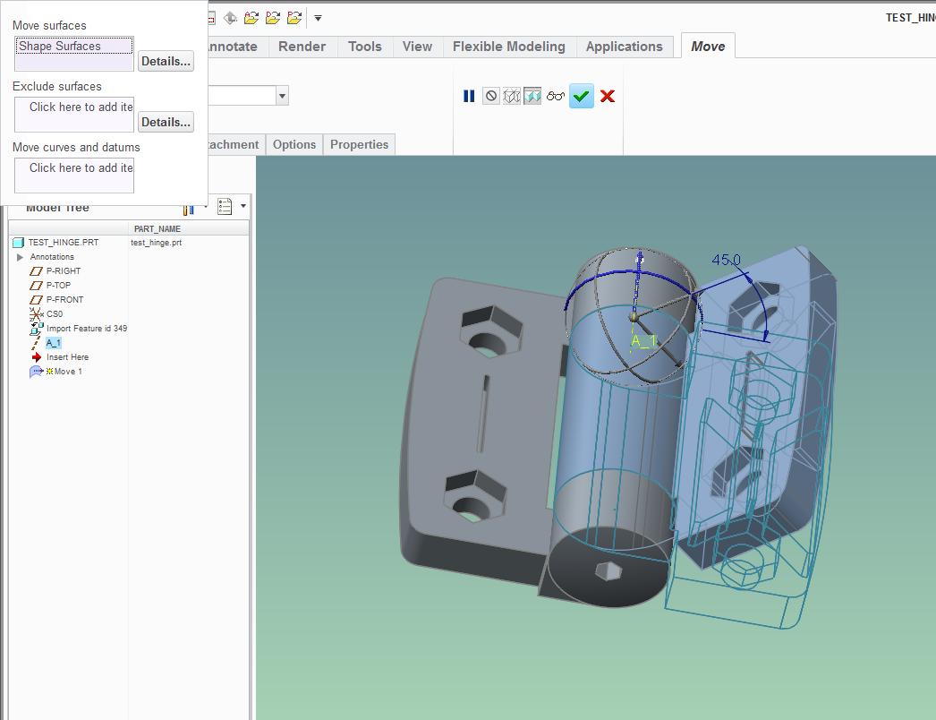

June 3, 2016
If you have the flexible modeling extension, you can use the "Move" feature to rotate the hinge to the angle you want:
Note how I created the axis A_1 before doing the move so that I can place the 3D dragger on it...
I used "boss with secondary" to get the Shape Surfaces set.
Last thing to say is that this keeps the hinge as a single part, but you won't be able to dynamically "drag" the hinge in the parent assembly.
