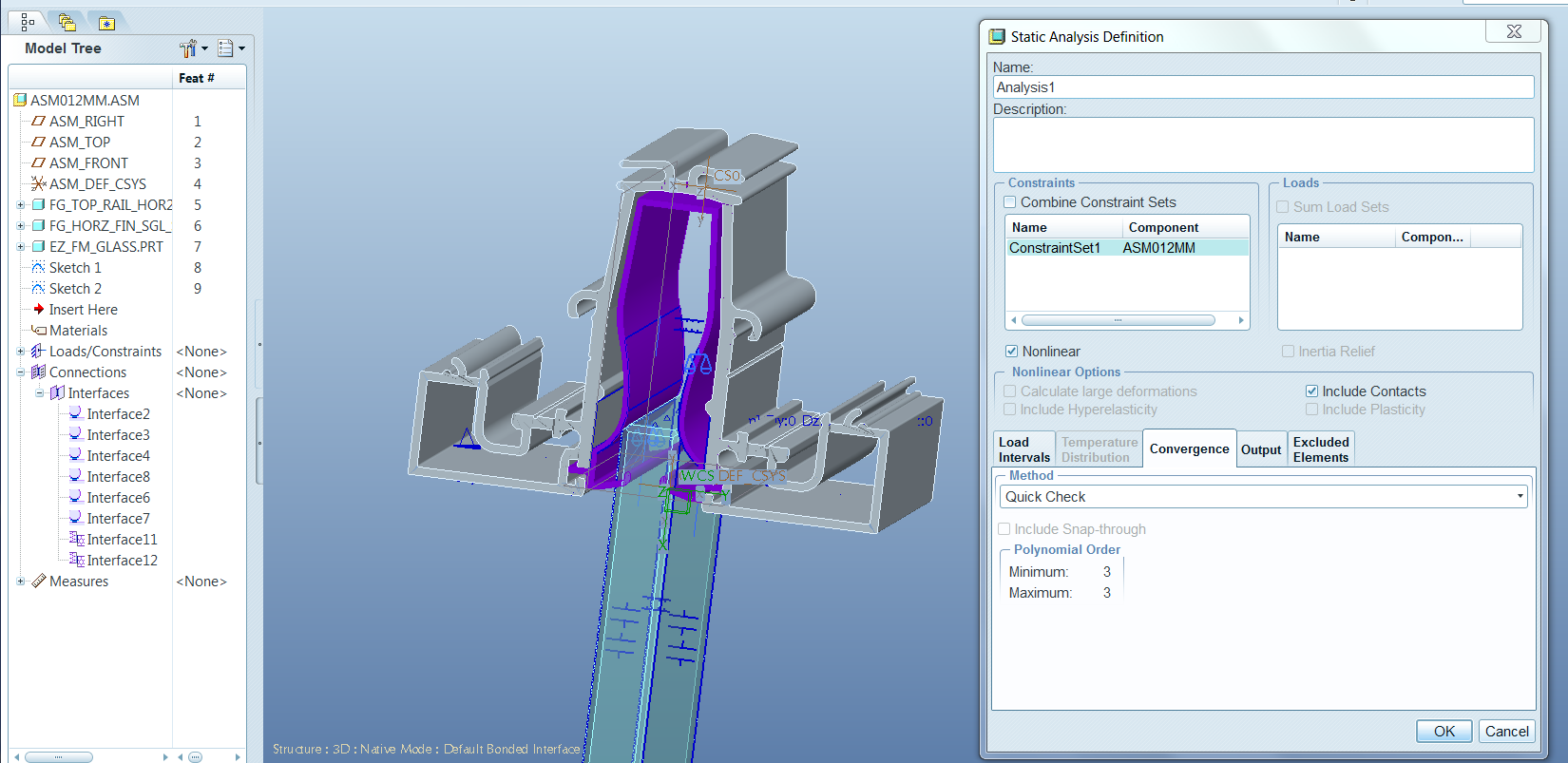

Hi all,
I have a problem with simulation setup.
To start, I am using creo/elments Pro.
The application: Glass as it fits within seal.

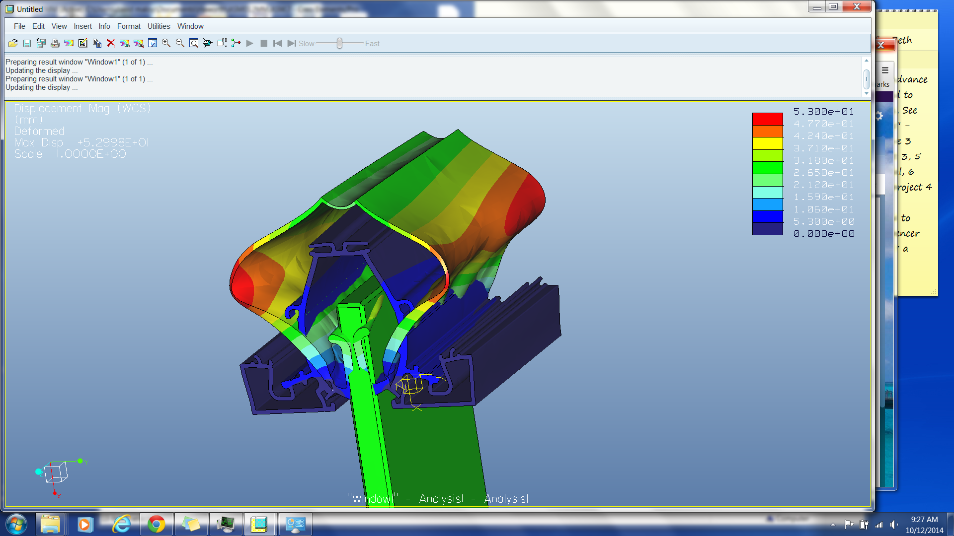

For 3 days now I have tried to get the results of the deflection of the seal as the glass contacts and deforms the seal. The seal interfaces with the glass on 2 sides. I have tried as many combinations of constraints and contact interfaces and have inaccurate results.
Materials.
The tempered glass young's modulus is higher than the polypropylene part. Hence the polypropylene should deform with some degree of prediction. The values can be found in the Creo part file.
The polypropylene young's modulus is based on the flex modulus. Values found in Creo part file.
Simulation requirements.
Parts with fixed positions.
1) Aluminum Channel (first part in model tree)
2) Polypropylene seal (second part in model tree) Note this part should deflect as part 3 (glass) passes by the seal. There are 2 area I am investigating. The polypropylene part has an hour glass or a pinch in area that should deform. This is my problem, how to set up simluation to get deflection of polypropylene).
3) Glass (third part in model tree) Note the glass travels inside of the channel cavity. The glass travels in the negative "X" axis a distance (-30mm). "Y" and "Z" axis are constrainted as fix.
Picture below of assembly with one setup shown. (Sorry, the picture is small, see the attached file call "image 1.png")
Pictures of some results. See attached file called "results image 1.png"

David,
A quick look and the following comments ...
  1. Model is symmetric, cut it in half. This will reduce the number of contacts and provide a model that is easier to constrain.
  2. You have tried to constrain the ends of the rubber by fully fixing rotations. This will have no effect on this solid model (rotational constraints will have an effect for shells/beams).Your model is solid, don't bother with rotational constraints. Instead ...
  3. Constrain Z-only at either end for all end surfaces (unless you intend otherwise ... this is only a quick look)
  4. I don't understand the constraints on the lines either side on the inside surface of the rubber part. If the glass is pushed up 30mm, it is the glass that will move the rubber out. These constraints appear to try to move the rubber along the axis of the extrusion and 'fight' the z-only on all end surfaces.
  5. Do not fix the underside of the Al extrusion in Z
  6. 30mm is a long way. Study the glass in position, frictionless contacts.
  7. Be really really methodical about the contacts, create them by hand and don't use component-component (my personal view). Attempt to anticipate what surfaces will meet. There may be several iterations.
  8. You need contacts between the horizontal and vertical surfaces of the rubber and Al extrusion where the rubber 'tucks in' to the extrusion (adjacent to the apperture for the glass)
  9. You are limited to contact OR large deformation in creo elements pro
  10. You cannot have contact and hyperelastic materials in creo elements pro
  11. Meaningful hyperelastic results (large movements) must have large displacement ON
  12. Consider a 2-d plane strain model. If you are limited to linear materialbehaviou/cannot use LDA due to the need for contacts, then you get your answers quicker
Question (that should be the first thing asked), what are you trying to find out?
If you get the opportunity to use Creo then you can step the glass into position, combine large deformation and hyperelastic and contact, I have yet to play with finite friction in Creo 3.0
Regards
Charles

Hello, David,
I see on your picture, a huge strain 53.0 [mm] in 1: 1.
I have not had time yet, for now, to see your file, but I've seen this problem came from materials units, all units have rechecked for consistency.

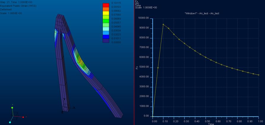

Here's a picture where I have used plasticity+LDA+enforced displacement to find the collapse load for a 2-memeber truss-structure. I apply the load at the top of the structure through an enforced displacement constraint. As the enforced displacement increases, the reaction force first increases until it reaches the collapse load of about 9500 N. As the displacement increases beyond this, the force drops as the structure collapses. This would be difficult to detect had the load been applied as an increasing load. The solver can't converge once the collapse load is reached and you try to increase the force further.
This was a quick'n dirty example I set up for educational purposes, so mesh/time-step is somewhat crude.
