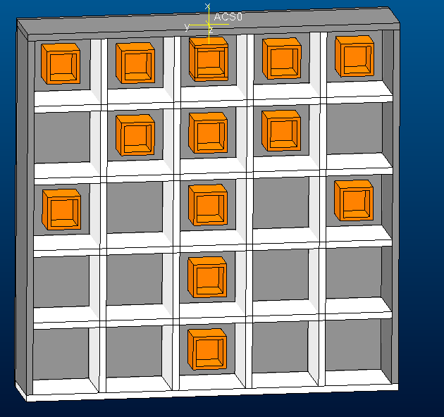

It's the first time I'm using Pro/Program and I want to replace a component by an other in an assembly without using family table.
To start with Pro/Program, I'm working on a simple example of a closet driven by inputs like number of column and number of row.
I added cubes in this closet using pattern and datum points created in a skeleton.
I want to change CUBE2.PRT by CUBE3.PRT
So I put in relation :
IF CHANGE_PART == yes
COMP = "CUBE2.prt"
ELSE
COMP = "CUBE3.prt"
ENDIF
and I've changed
ADD PART CUBE2 by ADD COMPONENT(COMP)
I've just "Fix" my part CUBE2 in the assembly without constraints and did a pattern with the datum points created in a skeleton.
So at the first time, it was working but when CHANGE_PART == NO, the replacement doesn't work and I have the error message below :
Is there something I forgot when I'm writting in ProProgram?
Is there a solution to keep constraints when I replace a part in an assembly without using family table?
Thank you,
Farida
Best answer by MartinHanak
Farida,
you have to create Interchange assembly and put cube2 and cube3 model into it. Then you define their interchangability, that means you'll inform Creo about corresponding references used to assemble part into main assembly. Unfortunatelly this functionality is not available in any Creo license, you need Pro/ASSEMBLY module in your license.
Martin Hanak
