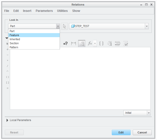

I have created a datum using a 'Feature Relation' and I would like to know where this reference is saved. For example I have created a datum from another datum and set the distance as 'D2/2' and pressed enter. This then displays another box saying 'Do you want to create a feature datum' which I selected yes. Now the problem is that I have since redefined this datum and just simply entered the correct distance but when I save my model I get a relations error and I cannot find the dimensions which are identified by this error. I have checked the Relations box and this particular relation is not shown, any ideas where I could find this?
Best answer by TomU
These will be placed either in the top level relations (Tools --> Relations), or in the relations of that specific feature.  (Tool --> Relations --> Select "Feature" from the drop down list, then pick the datum plane.)
TomU23-Emerald IVAnswer
December 3, 2015
