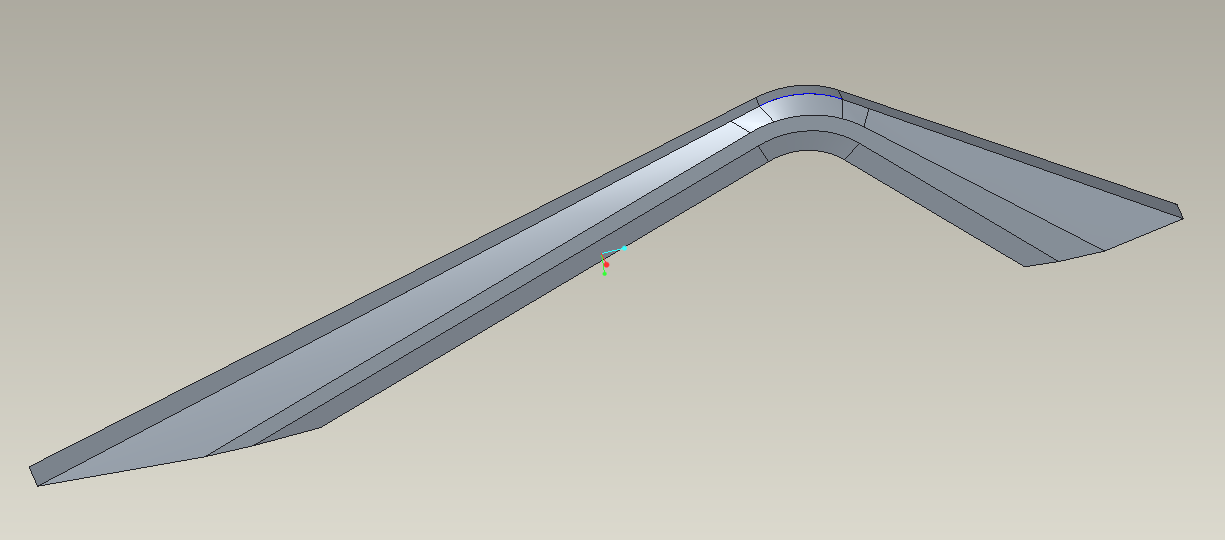

Hi everyone,
I am wanting to do a variable chamfer but I don't think Creo has that feature as yet.
So I have tried to use the swept blend tool instead. However it's not following the path I want. I want the section sketches to follow the edge of the part.
Picture below shows three sketches and path
How do Stop the cut from curving away?
If it's possible to used the chamfer tool it would make life a lot easier.

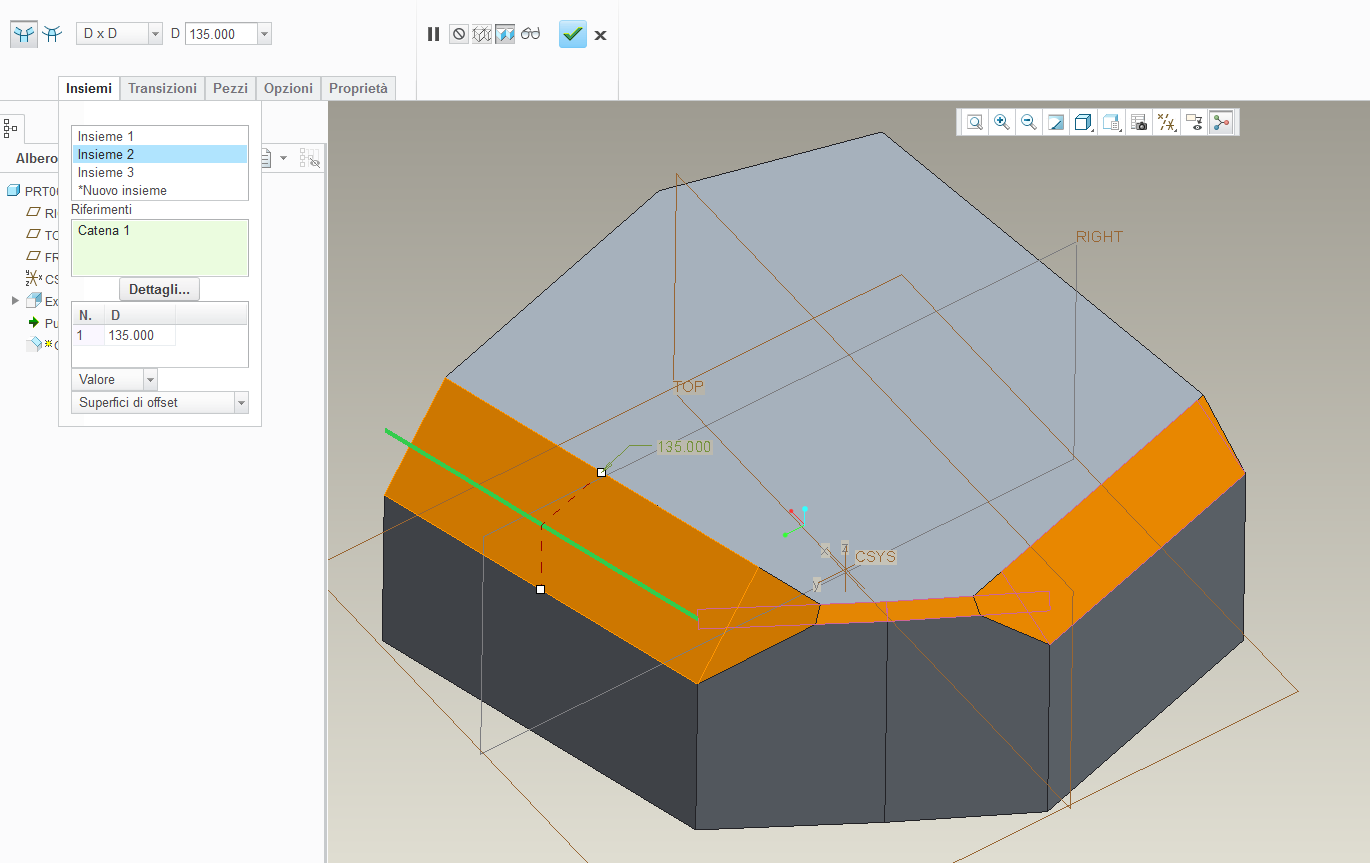

Best answer by MauroStefanovic
I try to get smartest chamfer with less control curves. Try to see if it can be useful

It's better for me if you post the part and we can work on it.
Chamfer variable on a edge doesn't exist in Creo, but you can do multiple sets of chamfer feature in order to change value changing edges.Cattura.PNG
