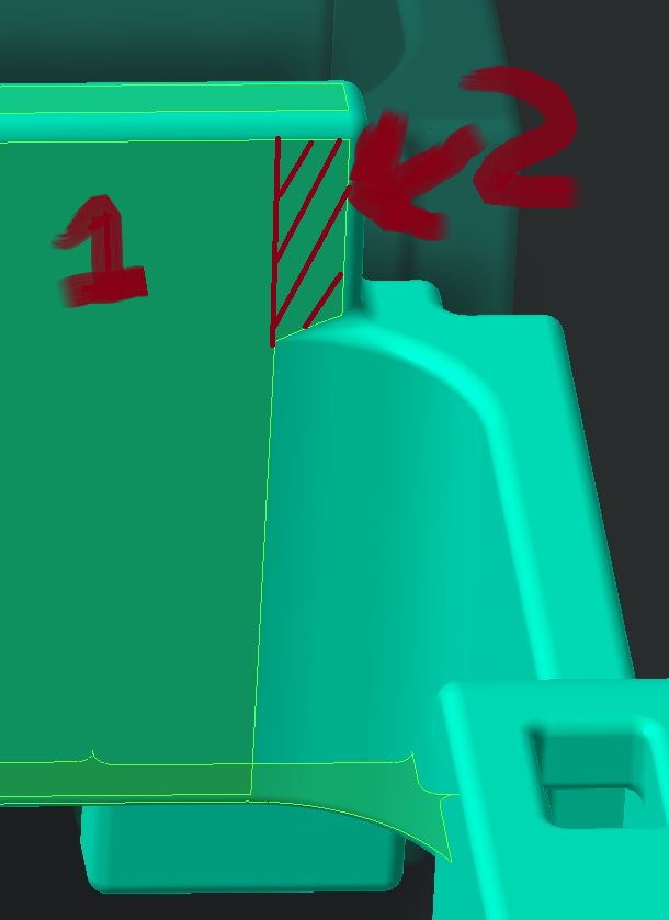

How can I vertically split a surface to draft in opposite directions? I have a feature that intersects a surface that creates an undercut if I pull the whole surface. I need to draft up to the feature and split it so the area above it will pull in the opposite direction. It will create a small mismatch, but this is acceptable.
Draft surface #1 in one direction and surface #2 in the other.

July 8, 2015
It's possible to split a single draft feature anywhere you want, in different directions and at different angles.
It's a bit involved and different than Bernie's sketch > project method. On the other hand, based on your pic, it may not cause a mismatch. In your picture, the border between area 1 and area two would be the split line?
I'll try to dig up some instructions I created some time ago for my designers.

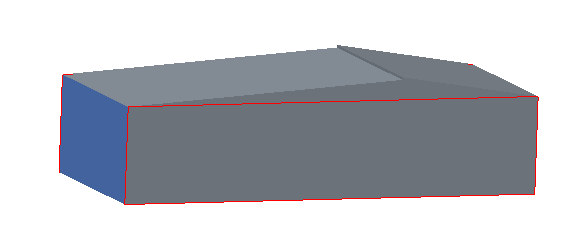

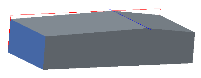

July 8, 2015
Alright, I didn't find the instructions, but it's less involved than I remembered it being. Perhaps it was the shape that was really giving me fits instead of the draft process itself.
There are actually two methods. The method to use depends on the draft hinge (where area 1 and area 2 meet on your pic).
Method one cuts back material from the split line (in blue). You can see the original shape in red.
Method two grows material up from the intersection of the blue surface and the top. If it's not split in the middle, there is a chance of mismatch. (Of course you could calculate out the exact angle each side needs to be based on where the split occurs on the overall surface size.)
The original shape, again, is in red.
