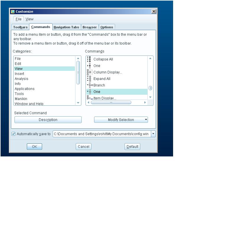

I recently switched from SW to Pro/E WF5, it is very painful. A lot of convenient things seem not available in Pro/E.
1. In SW, I can pick anywhere in an assembly, say an edge of a part, the part will be highlighed in the model tree on the left. In WF5, no way, it is difficult to do this backward matching, you can only pick in the model tree and see it highlighted in 3D model.

Best answer by rohit_rajan
there is one more option which would highlight the part no matter where it is deep inside ...
go to Tools> Customize Screen>View>One..select it and drag it to the toolbars somewhere..then select a part in the graphics window...and click on it..it will highlight in the model tree.

1. in wf5 also if you pick on the graphics windows it will surely highlight in the model tree and vice-versa.

For 1, it seems only parts in the top level assembly works this way, if a part in a sub-assembly, nothing will happen, but in SW, no matter how deep a part is buried, it will be found in model tree, and highlighted, which is very convenient.
