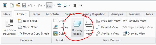

Request you to share some tutorial which I can use for to understand how I am able to insert different view from different instances of family table into a single drawing file.

You should be able to click on the model name at the bottom of the page and switch to a different model. After that, any new views created should be of that selected model.
March 27, 2015
Each instance is treated as a separate part. You have to go to the layout tab and add each instance just like you would add a model.
Whatever model is currently active in the drawing is the one drawing views can be created for.

I am able to set different instance into second sheet but as soon as I try to add view into it, model is changed to main (first model instead of the instance) instance ..
