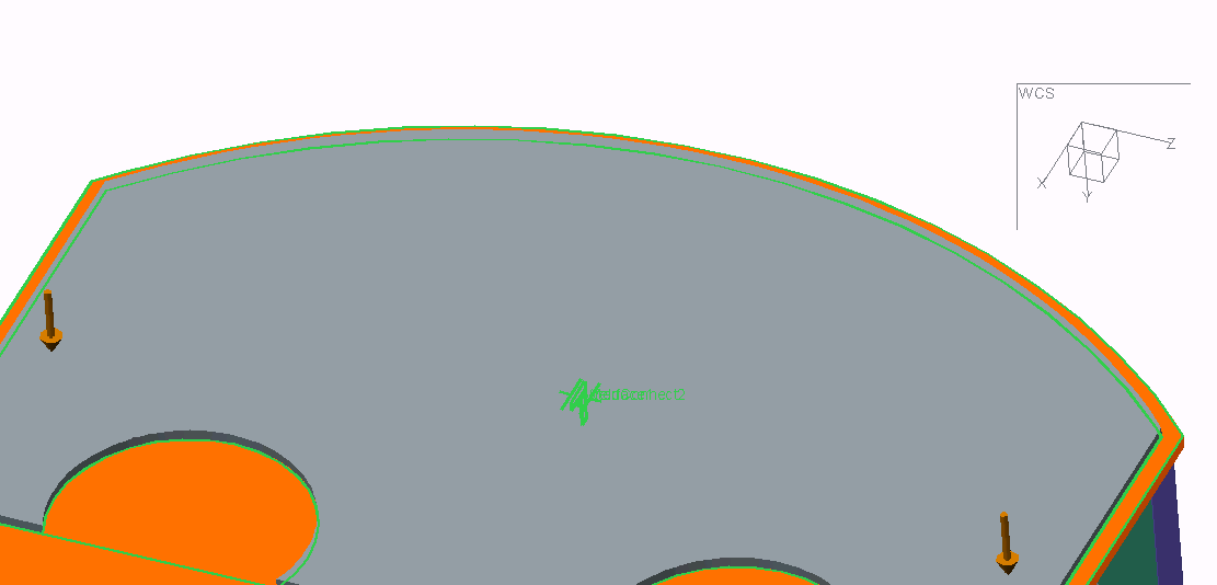

The contact is is between two surfaces have a perimeter weld around the border.
(I apologize for the terrible picture.)

Hi John,
Have you tried adding a surface region to both parts that your are assigning the contact region too to set the boundary for the weld penetration?

Is that not what Charles was suggesting?
Creating a surface region does work. Now I can create the appropriate contact and bonded interfaces.
Thanks Charles and Don.
