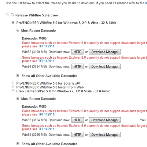

Pro/Engineer Wildfire 5.0 M060 is the same as all other 5.0 releases.
With the M070 build it is now Creo Elements/Pro. New load point, new
look to the shortcut icon, and new splash screens. All other
functionality is the same as any other 5.0 release. One thing that is
different is if you are downloading the software from PTC, for a release
after M060, you will need to make sure that you go to Creo Elements/Pro
section as shown below:
This caused some confusion when we were looking for the M070 release.
Like Doug said Creo 1.0 is due this summer. I would agree with Steve,
skip it.
Hope this helps clear things up.
