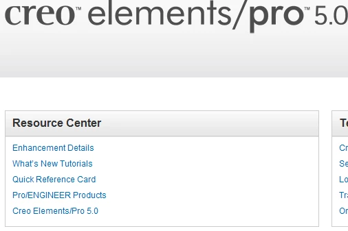

PTC puts out some very good training information. I have used these to help me understand what is new. These are free on PTC's website. If you don't have money for training, then use the tutorial below. Someone in your company must decide what goes into your config.pro and what is out of the box. A quick PowerPoint works as well. While this may not be as good as an instructor led training class it can help fill in the gaps.
The picture below is from the default browser window.
[cid:image001.png@01CC97D6.D2680650]
