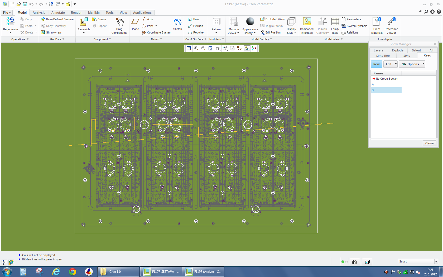

Hi
could you elaborate the problem you are facing with the two images
It is not quite clear to me
From the first image it seems that you are going for offset section, but you have joined first and end points(may not be required)
But actually I could not understand the exact problem you are facing

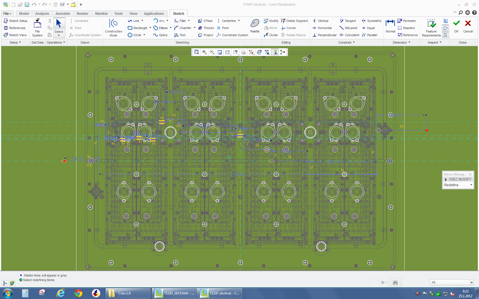

Yes, I am making an offset cross section of an assembly.
1st image shows the xsec after its completed. For some strange reason both end points of the xsec are connected with a line. This causes wrong display of xsec in assembly drawing.
2nd image shows the sketch of the xsection where everything is just how it should be as far as I know. Both ends of the line are overlaping the view and are not connected with adittional line as it is on 1st image.
In Creo 1.0 the free line points in sketches are shown in red. I am on Creo parametric 1.0 M020
Thanks.

Hi
I agree with you
In Creo it shows the ends with red dots(May be a new feature)
But everything else are the same.And you should not face any problem in creating section.
In the First Picture ;you can redefine the section and remove the extra line
Are you facing any other problem in creating section?

January 27, 2012
Jakub,
just to eliminate OPENGL problem, add temporarily the following option at the end of config.pro file, restart Creo 1.0 and open your drawing.
graphics win32_gdi
Martin Hanak

January 27, 2012
hi,
That additional cutting plane is still there even with graphics config changed
