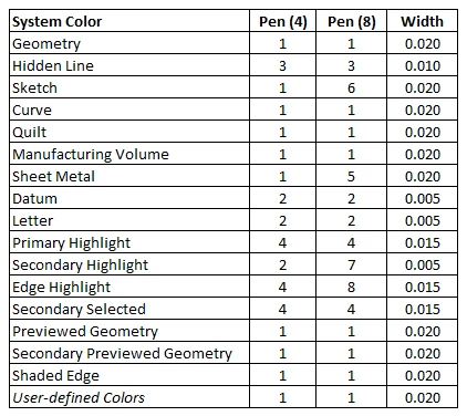

Where/what is the default pen lneweight settings when saving to a pdf without using a pentable?
  • March 25, 2019
  • 10 replies
  • 8071 views
I'm reconfiguring our practice of saving a drawing as a pdf.  I've set up a pentable which seems to be working ok.  I'd like to be able to see what the lineweight settings are for the pens when not using a pentable.  Is there a location or option for this in Creo 2.0?  I see that the config options for the pens (ex: pen1_line_weight) refers to an electrostatic plotter, which I take to be our ink plotter.  The only options I see and am using that refer to pdfs are pen_table_file and pdf_use_pentable.

Probably not super precise, but measuring a PDF containing lines of each pen type shows three line widths in use:
  • 0.125 mm (.005 in)
  • 0.375 mm (.015 in)
  • 0.500 mm (.020 in)
See attached PDF.
Note:
  • This PDF was created with Creo Parametric 6.0
  • Even though the PDF refers to 8 pens, the config option 'use_8_plotter_pens' was set to 'no' when this PDF was created.

I did some more testing.  Here is what I'm seeing in Creo Parametric 6.0:
  • If line width is set to zero (default), then pen table values will be used.
  • If no pen table is present, Creo default values will be used.
Default Pen Table Values (inches)
Default Pen Assignments
Note:  The use of 4 or 8 pens is controlled by the config option use_8_plotter_pens.
