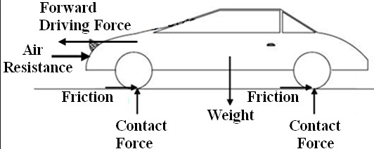

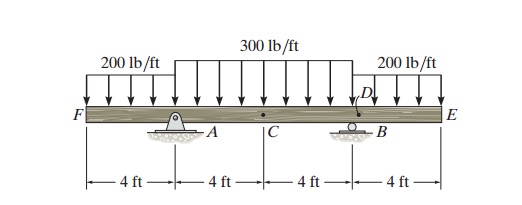

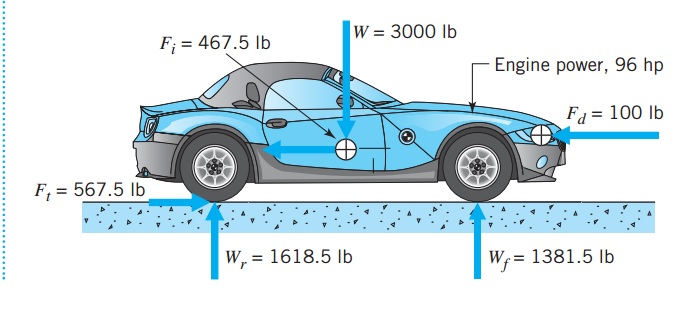

Attached: Pictures that contains the kinds of diagrams I am interested in drawing.
Disclaimer:I didn't draw and I don't own the copyrights of these pictures. These are just selected pictures form a google image search to demonstrate what kind of diagrams I am talking about.
Thank you !
