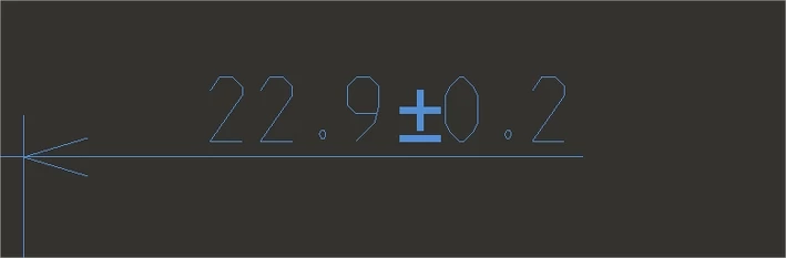

we moved to Creo 4.0 this week and I realized that the Dimension Tolerances are bigger than my dimensions
can this be changed?
where to find this setting please

Best answer by Mahesh_Sharma
@Vermont_95
Try setting drawing option symbol_font as legacy
Mahesh_Sharma
22-Sapphire I
January 30, 2019
@Vermont_95
January 31, 2019
 Perfect!
  thanks
Veronique
