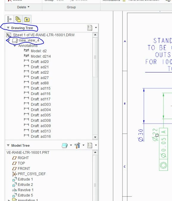

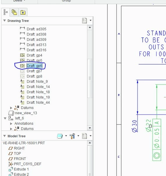

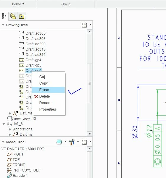

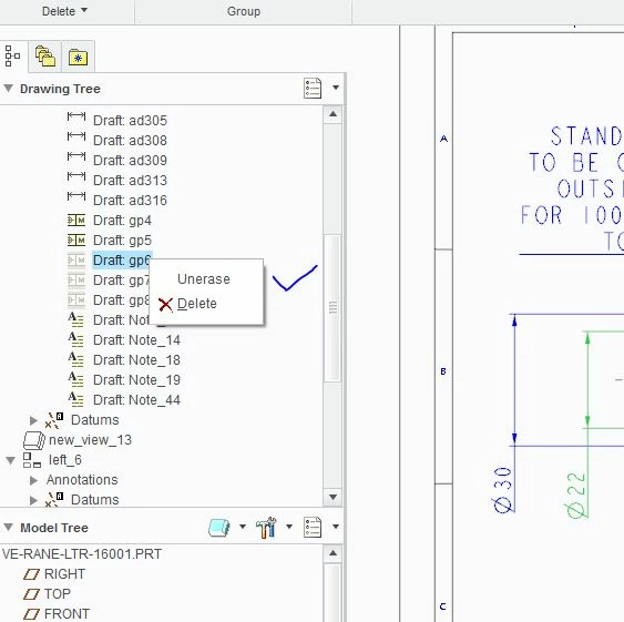

January 18, 2018
Generally you cannot delete the attached GD&T to the dimension but you can erase those GD&T by doing the following steps
Open drawing file
left side - There is Drawing Tree
