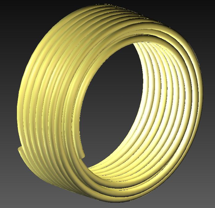

I have been asked to create a model of a cable, wound in a series of layers onto a spool, like a winch cable onto a drum.
The smart money says 'Don't do it', because it will take an age to regenerate. I know that. However, I want to know how to do it anyway. I'm curious like that.
I first made a series of curves based on equations like the one shown below:
For each layer, I reversed the z direction, incremented the r value and started theta with an offset so I could fake the join between layers using a curve between points, tangent at each end to the spiral curves.
Once I had a series of coiled layers and joins between them, I tried to Copy, Paste, Approximate, the curves to make the whole ugly mess into a single composite curve. No! Can't do that. No idea why not, but Pro/E insists they should all remain separate curves.
So, then I made a series of separate VSS features, one for each layer and one for each joining piece.
That worked after a fashion, I ended up with the model shown:
However, what I would ultimately like to do is to have the whole cable as a singe curve and control the number of layers by making the overall curve length a fixed value. So, if I tell it that 10m of cable is paid out from the winch, I want to have the remainder shown coiled up on the drum.

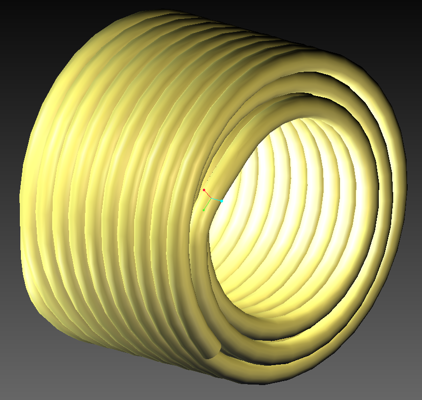

Today, I have tried a different route: I made a spreadsheet to calculate the r, theta & z values and used it to create a datum point feature, then made a single curve and a VSS to make the cable reel.
That's fine, but not easy to modify when values change. Extra steps, exporting the points and changing file names, etc.
I would like to pursue the original method, with a number of separate curves, but I think I really need to be able to combine them all into one single curve, so that I can play tunes on overall length and cable tails, etc., without it all falling over.

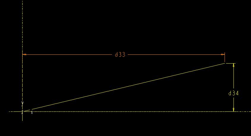

November 7, 2013
If you want to make your cable as one piece look at http://communities.ptc.com/docs/DOC-3063
I devised it for springs, but anything that is wound would work the same.
JWayman1-VisitorAuthor
November 7, 2013
Thank you, David.
I have had a go using this technique and the results look OK, though i say it myself:

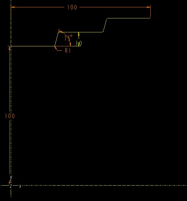

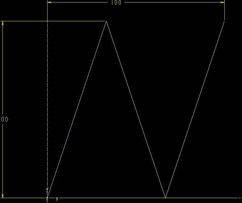

I used 3 graphs:
Radius,
Turns
and
Z_Value
Each graph was based on a maximum extent of 100.
The curve was constructed using the equation:
r =evalgraph("radius",t*100)
theta = 360*evalgraph("turns",t*100)
z=evalgraph("z_value",100*t)
Add a VSS and Bob's your Uncle...
