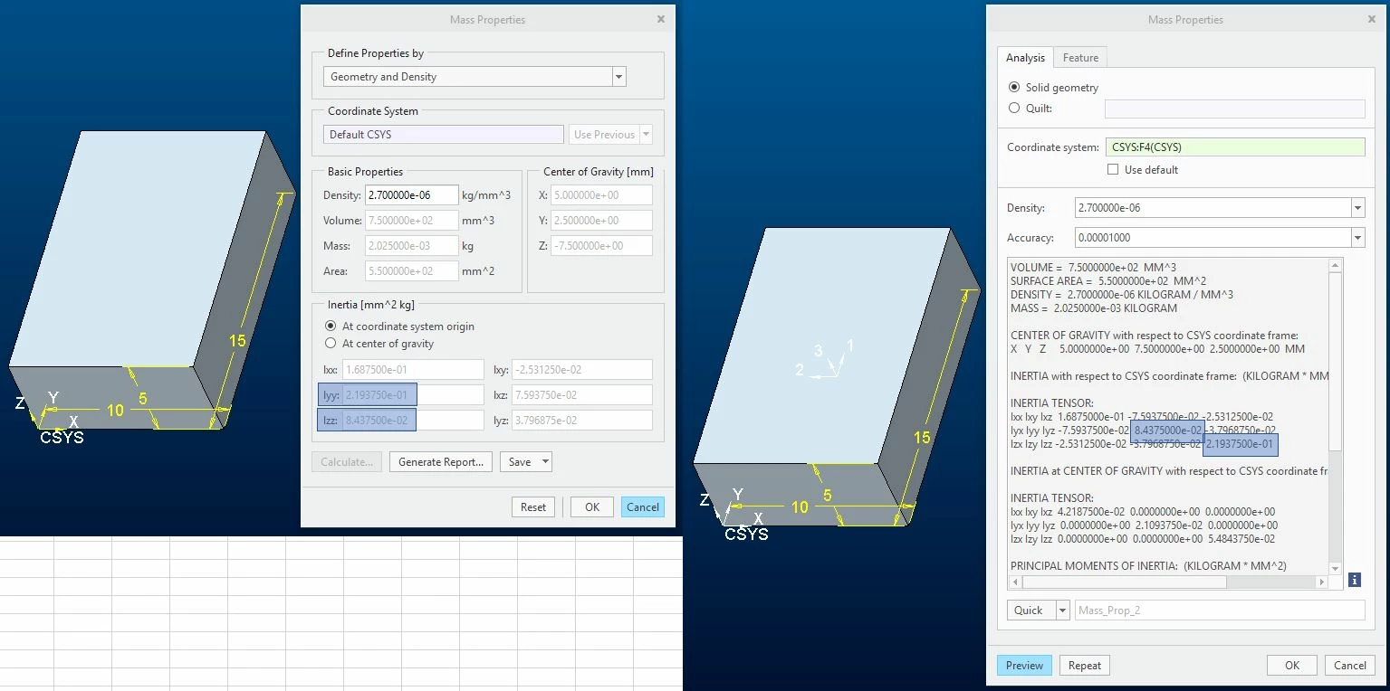

Hi all,
It seems that the marked 2-2 inertia values have been replaced in every case. Iyy and Izz.
(File/Prepair/Model Prop/Mass Prop <--> Analysis/Mass Prop)
Is it normal?
Thank you for the answers.
Best answer by MartinHanak
  • in left dialog box you use default CSYS
  • in right dialog box you use non-default CSYS named CSYS
I think the above two CSYS have y and z axes pointing in different directions.
July 5, 2019
bopeti5-Regular MemberAuthor
July 29, 2019
Yes, you are right, thank you
