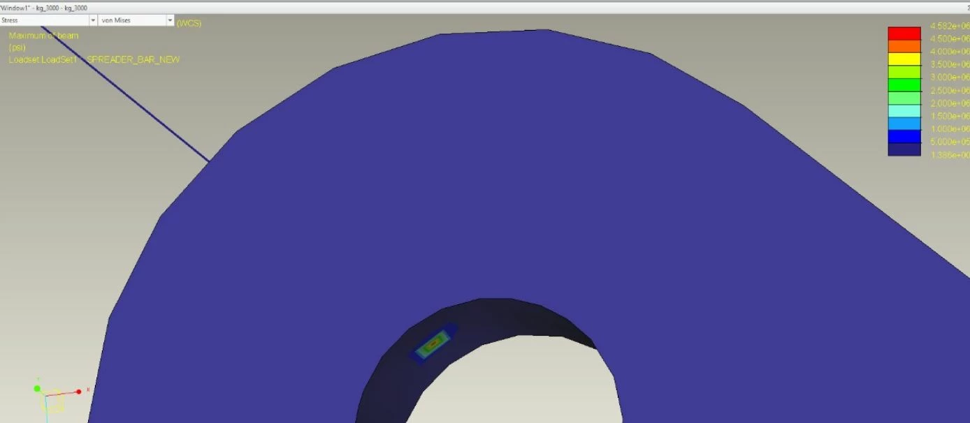

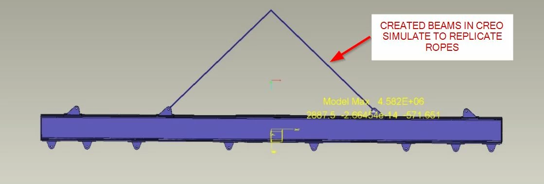

Hello All,
 I am checking the carrying capacity of I section beam. I have applied 3000kg of load downwards divided equally into 8 bottom lugs. Two top lugs are tied to sling/rope leading towards a single point. I have created beams in creo simulate 7.0 to replicate the ropes using two end points - one on lug and one on top at a certain height..
see attached pictures for your reference
However after running simulation I am observing a high point load on lug where the beam starts. This seems to be something unusual. I believe the load should spread on the hole of lifting lug. Can you please advise if you have any suggestion to improve the definition of sling/rope in creo simulate? is there any better way to perform it? I would highly appreciate your help with it.

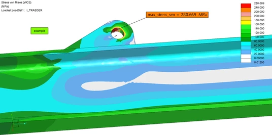

I would simplify the FEM model (example).
skunks
Jul 31, 2025 5:40 AM UTC
example:

Hello @skunks
Great example. I am trying to replicate a similar study for which I set up my model like you have suggested above. However, there seems to be something that I am missing or not doing correct as I am seeing funny results. If you could please check my model to see if you can find any missing pieces?
Kind regards,
Yash
