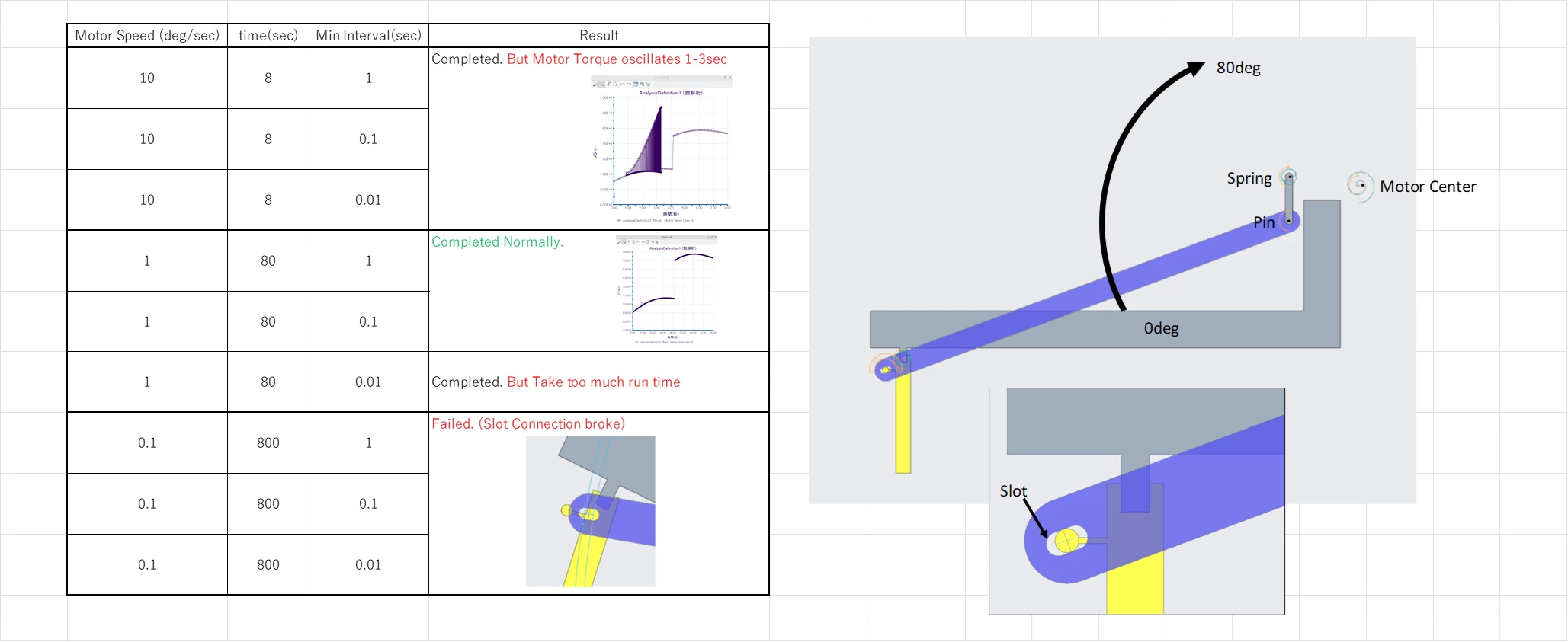

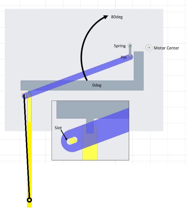

I am simulating the attached link mechanism (car seat flip-up with leg folding) in Creo MDO.
(To get operating torque for seat flip up at each angle)
However, the measured motor torque varies significantly depending on the flip-up motor speed and the minimum interval settings.
In my current model, I observed the following:
 Motor speed: 10 deg/s
 Minimum interval: 1 to 0.01
 Result: Motor torque oscillates significantly.
 Motor speed: 1 deg/s
 Minimum interval: 1 or 0.1
 Result: Stable torque results.
 Motor speed: 0.1 deg/s
 Result: Simulation fails because the slot connection breaks.
Based on these results, it seems that using a slower motor speed and a smaller minimum interval does not always improve simulation stability.
Could anyone explain why this behavior occurs and share any recommendations for improving the stability of MDO simulations? Any best practices for selecting motor speed, interval settings, or other solver parameters would be greatly appreciated.
(I was able to find a set of conditions to run successfully. However, I would like to better understand the underlying factors affecting simulation stability so that I can troubleshoot similar issues in future models.)
Thank you in advance for your help.

I think you have two issues.
1) I was using a slot constraint and I was getting a lot of “bounce”.   So I switched to include a really long lever to control the motion.
2) I found that in dynamic analysis the velocity control was really unpredictable. Especially with a spring in the loop.  You can measure motor torque directly using the “net load” measure.
