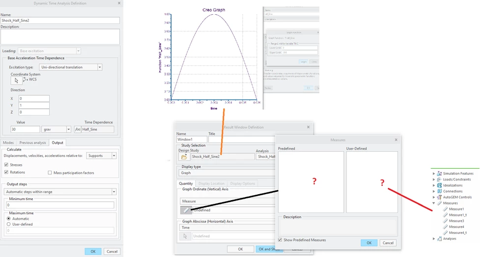

Why are there no results can be plotted in half-sine 30g impact shock analysis!?

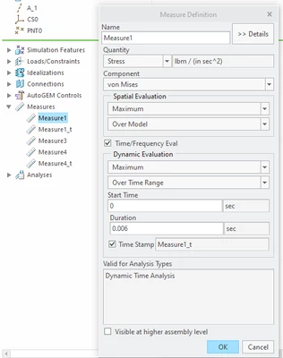

I have finished a half-sine 30g impact shock analysis, however, I can't plot any results even I have defined some "measures". What could be wrong?!
 What could be wrong in setup?

I am not going to be able to answer your question, but unless you are sure that there are the same number of time steps for each analysis I don't think its fair to compare times head to head. Also you may have slightly different geometry in both solvers (one is likely a conversation of the other).
What measures did you define and did you confirm that they are valid for the analysis you are trying to do?
I have compared solvers head to head before and for medium to complex geometry you are never going to get exactly the same answer. This is part of the reason that factors of safety are used.
Oct 27, 2022 4:21 PM UTC
You are right, the comparison on time usage is not fair, except that it is easier to get results and plot results in SolidWorks Simulation because there are far less buttons to click in SW so there is less chances to trip off. (And this is the first time I try to learn SolidWorks Simulation to run half-sine impact shock analysis! It took far longer time to define correctly the half-sine curve in CREO than in SW for a first time user). I defined one measure as follows:
There might be somewhere wrong in the definition. Thanks for your time.

Did your modal analysis run successfully?
If you haven't already I would suggest you watch Lino's video at the link below. At the 48 minute mark he goes over what looks like a very similar problem.
https://community.ptc.com/t5/Creo-Parametric-Tips/Creo-Simulate-Advanced/ta-p/821215#M1043
