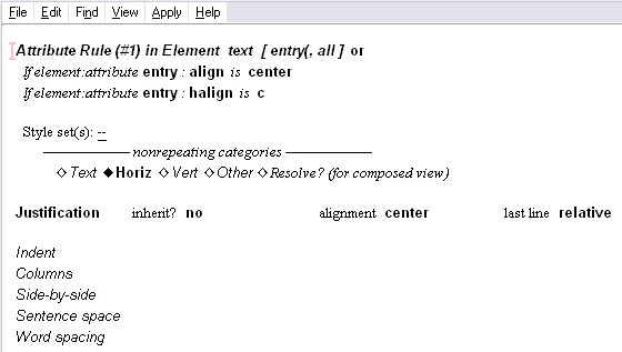

    September 28, 2010
    Hi Suzanne,
    That attribute had to do something. Digging a little further, when in
    Epic Editor if I choose format/modify element-in-context I find the
    element text in the context of entry is set to inherit missing
    categories. It has an Attribute Rule or:
    if element: attribute entry: align is center
    if element: attribute entry: halign is c
    I'll look in the FOSI with a text editor for these values.
    Greg
    J
    September 28, 2010
    Wow, I got myself turned around J. Ok, the first set of e-i-c's I quoted
    were from the screen FOSI. There is a lot of code in the print FOSI. You
    may find this snippet useful, the e-i-c for the "text" element below in
    the context of entry is from the print FOSI:
    <e-i-c gi="text" context="entry" row=" tbody&quot;=">
    <charlist inherit="1" charsubsetref="block" hyphen-en&quot;="></charlist>
    <att logic="or">
    <specval attname="align" attloc="entry" attval="center">
    <specval attname="halign" attloc="entry" attval="c">
    <charsubset>
    <quadding inherit="0" quad="center" lastquad="relative"></charsubset>
    </att>
    The elements english, french, and text are often used interchangeably
    within the element entry. I note that "quadding inherit" is set to "0"
    (not to inherit) and the quad is set to center. At this stage, I'm out
    of my depth, as the specval attname="align" is still used with a value
    of center. I'm not sure how that is interpreted to turn out centered
    text in printed copy. More reading to do I guess. I've got the Arbortext
    FOSI Reference,AE 5.4 F000 of June 2009, so I guess it's a good place to
    start. J
    Greg
    September 28, 2010
    And there's your problem. At least, as far as any 'header' row is concerned. The context is "entry row tbody", which in SGML/XML path parlance is tbody/row/entry/text. You need an e-i-c for thead/row/entry/text, which would be context="entry row thead" (or more simply context="* thead"), if you want to format the content in a header row.
