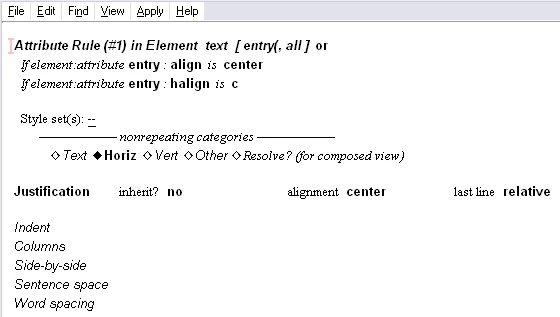

This relates to my previous post on table formatting. I've got a new
problem where I'm trying to format the header row of a table. I want to
set the text to center justify. Setting this in the FOSI doesn't change
the output even though the "resolve" display shows it as center.
When I select the row with Table Properties, it seems like Left justify
might be the default - Left is what I'm finding as my output.
For table width, PTC indicates that having a full width table is the as
designed intention when columns are set proportionally. Setting the Table
Property of Use Default (100%) seems to have no effect.
Setting the columns to fixed values makes the table set to less than full
page width. I thought that maybe center justification needed a fixed
width, but that didn't change anything.
Any idea why my headings will not center justify?

    It looks like Suzzane was right. there is an align proerty on the entry
    element that appears to take precedence. If I set that to center, then I
    get the headings I want. I'm writing up a bug report for PTC as I think it
    is at the very least wrong that the "Resolve" results shows center rather
    than the true value that is being used.

    In Reply to Suzanne Napoleon:
    You will have to confirm this with Arbortext Technical Support, but I think
    quadding coded in the FOSI is overridden by the horizontal alignment setting in
    Cell Table Properties. I think the problem is that the default selection is
    Left. There is no Inherit or Default choice for quadding in Table Properties.
    For example, if you code a font family in the FOSI for entry, it is used unless
    the Modify Cell Font Table Property specifies something other than Inherit for
    the font family. This choice overrides the FOSI. The same thing with table row
    breaking. It has a choice of Default, which means whatever is coded in the FOSI.
    Other row breaking settings override the FOSI setting.
    Again, please confirm this with Arbortext, and also please share what you learn.
    I'll put it in Essential FOSI.
    >>> Here is the response I got from support. Basically the table implementation is older than FOSIs and does things different (hard wired) and some things just can't be controlled via the FOSI. To change would be a lot of work ....
    Regarding “Centering cell content with FOSI - bug?”
    Thanks for further clarification of this issue. This is not considered a bug by Arbortext. The situation is that we implemented table creation technology long before we implemented FOSI technology. Our software is coded for the Table Editor to control the look and feel of tables. We did this so we could convert table tags to a graphical image so people could edit in something that looks like a table and not just a bunch of tags. It also draws all the row rules and segments. As a result, the Table Editor controls the structural look and feel of the table. With this in place, the FOSI is not coded to override attribute settings in the table structural elements. You can code the eic to be always centered but it will never center as long as entry has align=none. Align=none is the controlling factor, not the stylesheet. This is the Table Editor taking control of the table and FOSI does not trump the Table Editor.
    What the FOSI can control is the justification applied to markup used inside entry. That’s where the discussion of the element being a block comes into discussion. If you authored inside a paragraph, you could set a paragraph inside * thead to be always centered and it will work so long as paragraph is a block. Attribute settings on entry are ignored. The FOSI controls this because it is not a table structural element.
    The eic panel shows a resolved value of centered because that is how the FOSI is correctly coded. The FOSI is coded perfectly and it will show the correct resolved value according to FOSI code. What the resolving technology does not take into account is something outside the FOSI. The Table Editor is not part of the FOSI code so the FOSI doesn’t take this into account.
    I’m sorry, but everything is just designed this way. It’s always been that way and it will not be easily changed. It’s part of our core code. Had we chosen to implement tabdesc as defined in the outspec, then, perhaps the FOSI would have been able to control the look and feel of tables. Since we already had a robust table creation and formatting technology, we decided not to implement tabdesc.
