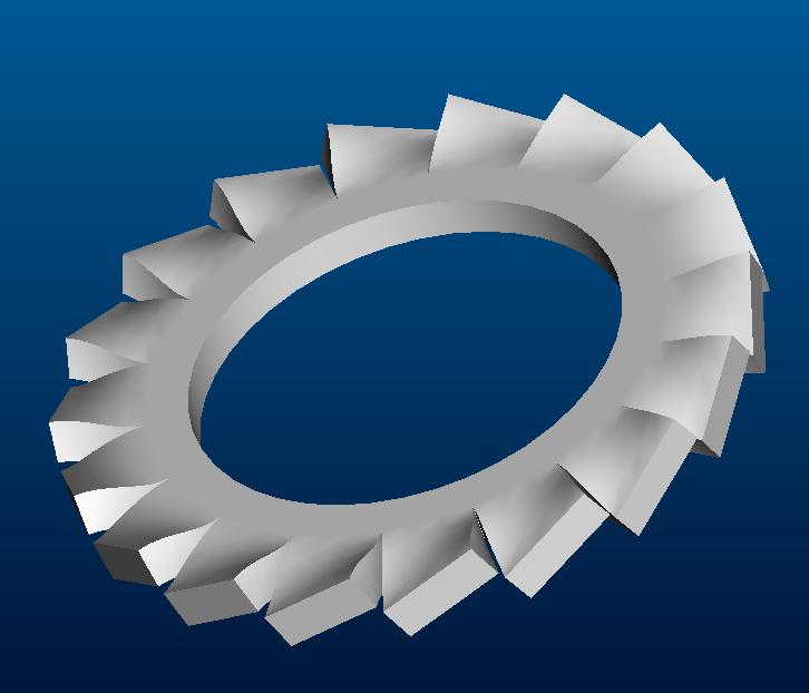

    This was more challenging that I thought.
    I do not have WF4 but I think you will get the idea once I upload the video and write a quick tutorial document to go with it.
    As always, the patterning of the radial features was less that simple. Even when I thought I had it, they were not evenly distributed along the surface. That is when I added a properly "fit" surface, the pattern worked fine (and clicked through to selecting the quilt rather than the surface!).

    the toothed washer above is not exactly what I meant. Think of a circular washe faceplast with pointed geared teeth cut into the face tappering toward the center.

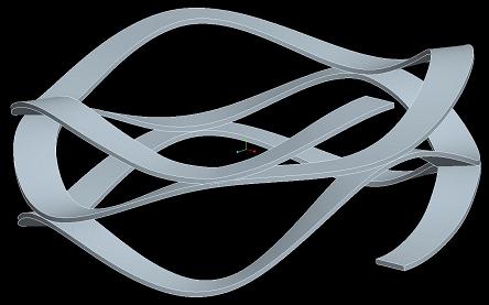

    Is this what you wanted? This is an OLD part I did, back before 2000, on probably V17 or so.
    Mar 11, 2013 9:27 PM UTC
    That would be the wavy washer, I'd typically be looking for more waves in it though. Great file, even with the tree I can't figure it out. Maybe you could explain it a bit more.

    How about this multi-level one?
    Mar 12, 2013 6:09 PM UTC
    Curse you and your crazy geometry Frank! Every time you post something, my personal time evaporates. I just figured out how to make single trajectories with rotational reversals... and then you show this!
