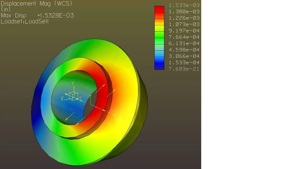

    Running the simulation with a pressure load applied on the bore and selecting the check box for inertial relief under static analysis worked perfect!
    Chris.
    May 17, 2011

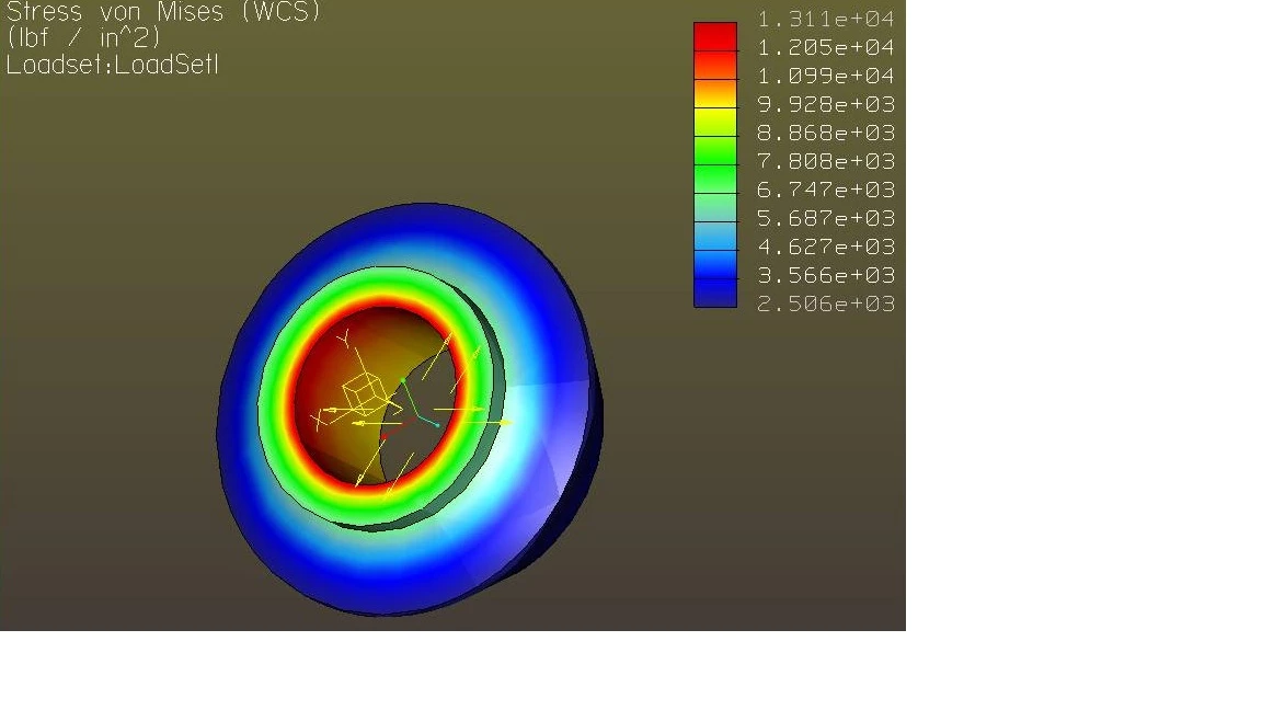

    looking at the analysis results for stess everything looks as expected... what up with the deflections?
    May 17, 2011
    Artifact of the viewer. Plagues most FEA programs. Linear simulations will
    determine the new node locations
    for elements. The path is a straight line. Therefore, when animating or
    showing scaled up versions of cylindrical
    parts the parts may appear to "swell" radially.

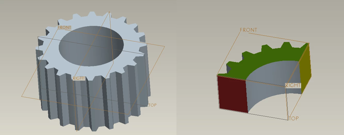

    Chris, I'm afraid applying Inertia Relief in this particularsimulation is incorrect.
    Inertia relief will apply mass/inertia forces throughout the model to balance the applied pressure, while inreality the pressureshould bebalanced out by the hoop stress alone.
    See attached for the details. It will also explain the displacement plot you're observing.
    Instead, I'd suggest to use one-tooth model (cut it out from the full model), along with the Cyclic Symmetry. (other options might be to solve 1/4, 1/8, etc models with the proper Mirror Symmetry constraints).

    For your gear problem try creating a 1/8th symmetry model. On the symmetry
    (or slice) surfaces place a symmetry constraint.
    The symmetry constraint is analogous to constraining all displacement normal
    to the symmetry surface. You will then have
    a fully constrained model without the constraints influencing the results.
    Using symmetry is how you would do a pressure vessel as well, assuming there
    are no external frame connections.

    This is an easy problem.
    Rather than using the 'inertial relief' or 'cyclic symmetry' you would be
    better off using a pie slice with 'reflected symmetry' boundary conditions
    and a soft spring to keep it from moving in the axial direction. The rule
    for reflected symmetry on a solid model is that the displacements in a
    direction normal to the symmetry plane are fixed and the displacements in
    the plane of symmetry are free. It would be easiest if you created a
    cylindrical coordinate system, then constrain only the tangential
    displacements on the two symmetry planes.

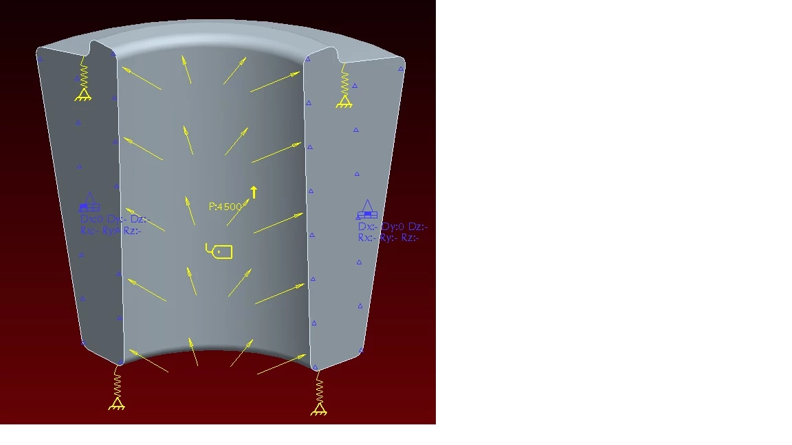

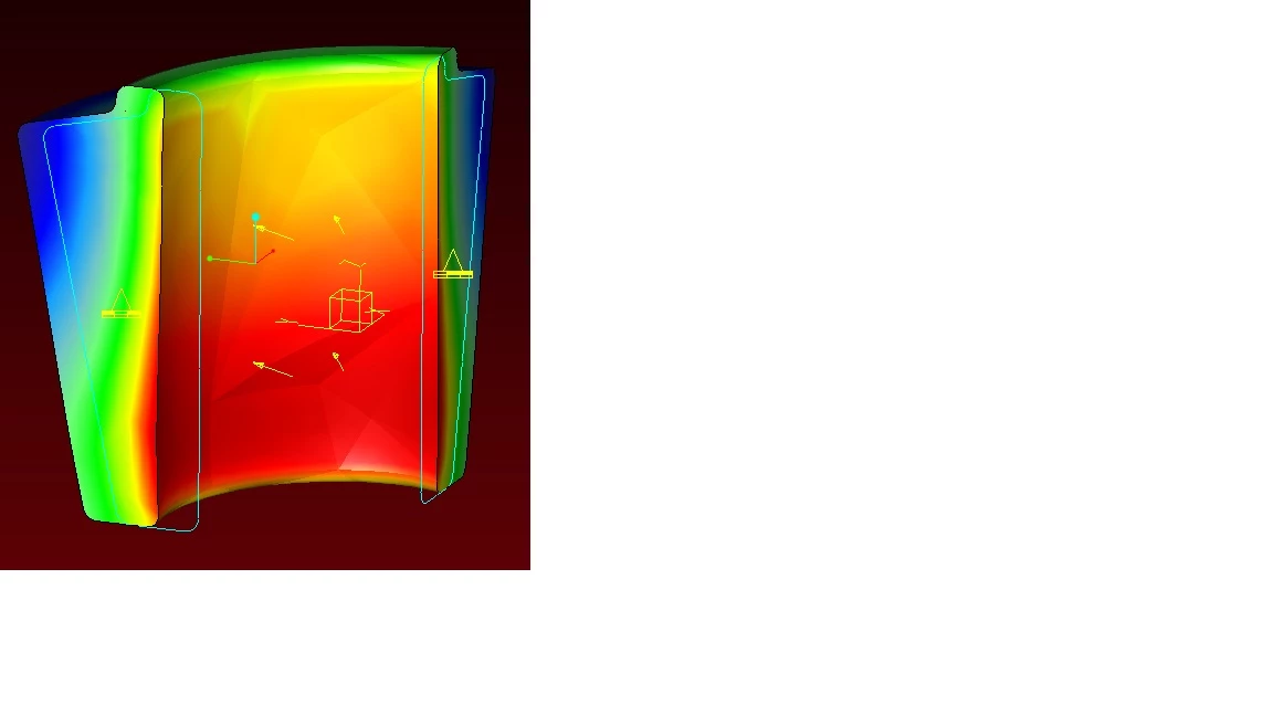

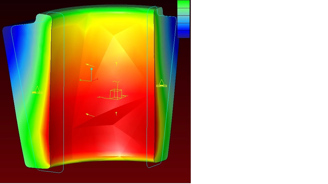

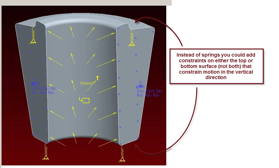

    Thank-you for the information! I tried setting up the system as you’ve suggested, I’ve a 90 degree piece constrained on the symmetry surfaces. On one surface constrained X and Z, the other Y and Z, rotations are free. The displacement is closer to what I would expect, as you can see from the displacement picture, it expands radially but since it’s constrained on Z there is no deformation from top to bottom.
    So I removed the Z constraint on those surfaces and placed 4 weak ground springs; the pressure load is 4500psi the springs have a stiffness value of 1 lbf/in (extensional), 1 in*lbf/rad (torsional). Looks good, is it valid? ...I think so. comments?
    Chris.
    May 18, 2011
    Chris,
    One option instead of using the weak springs, you could place a constrain on
    either the top or bottom surface to constrain motion in the vertical
    direction. However, do not place the vertical constraint on both. (see
    attached). This would be an alternative if the springs were creating
    localized stresses or causing some sort of other problem.
    Also, for meshes containing solid elements (shown in blue) there is no need
    to constrain or unconstrain the degrees of freedom associated with rotation.
    Solid elements only support translations. However, beams, shells, and
    springs do support 6 DOF (3 translation and 3 rotation).
    Other than that the deformation pictures seem reasonable given the tapered
    design. I don't know what the magnitudes are and if they are correct, but I
    am sure you can lean on some prior product data at your facility.
    Steve
