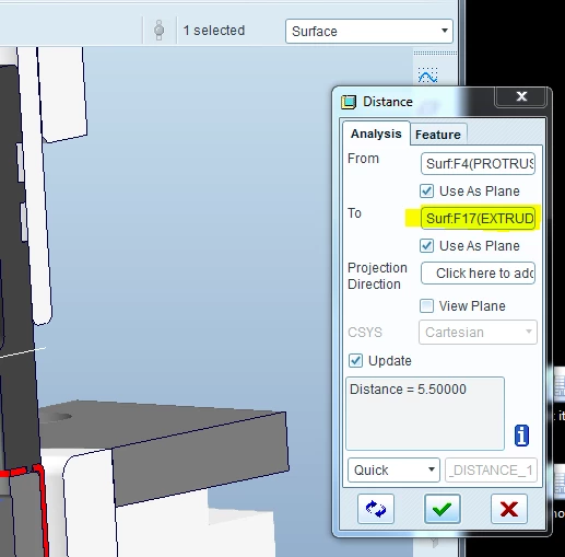

    September 28, 2012
    That's not necessarily accurate. To pick another surface as the 2nd object, simply click on the "To" box (highlighted below) in the GUI window then pick the surface.
    No need to start over.

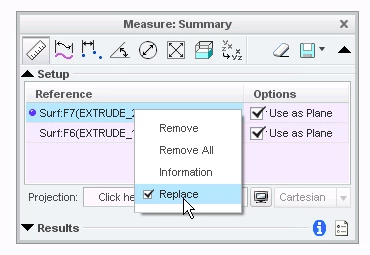

    The repeatedly pick new items is available in Creo 2.0, but it is implement a little backwards, so to say.
    One of the users here discovered, that after selecting two references you can RMB on the reference you will change and select Replace from the menu. Now every selection will replace this reference and keep the other.
    [cid:image001.png@01CD9D92.A769B080]
    The benefit to previous versions are that you can pick the first two references in any order and decide which to replace or swap the replacement as you go.
    Another trick is to press and hold Alt while selecting to by-pass the smart filter. It enables you to pick an edge directly instead of drilling down into the model > feature > surface > edge.
    /Bjarne

    Steve,
    The dialog shown is WF5 and earlier, the Creo 2 measure tool does not
    have separate 'From' & 'To' fields.
