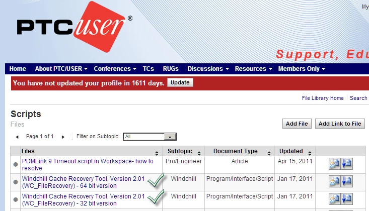

    October 18, 2012
    I'll agree with others that you really should use dm_upload_automatic YES
    But as for loosing files when your cache gets corrupted, that's not entirely true.
    The files are still there in the cache and are still good files. You just need to recover them.
    You need this program from the PTCUser site:
    [cid:image001.png@01CDAD19.101B61B0]
